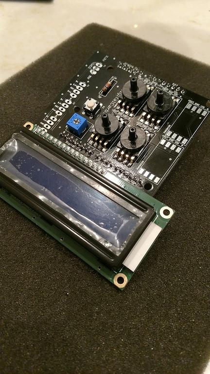

Basically:
1. Mount the sensors.
2. Mount the 2 switches and resistor.
3. Put header pins into the arduino, sync board on top of that and solder. The sync board plugs/unplugs.
4. Solder pins to the LCD and then solder that to the sync board.
5. Solder either header pins or a jump wire to the power selector.

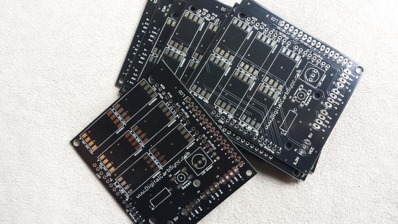

Here's a photo of my new black label boards. A little more expensive for me, but lead-free (can export anywhere) and with some minor text improvements. Most important, fast and reliable supply.

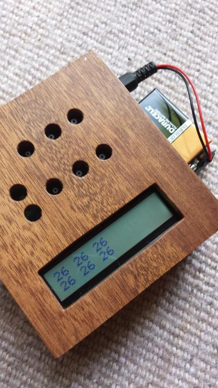

A friend built a box. Looks pretty good, and functions just fine, but not a real solution.

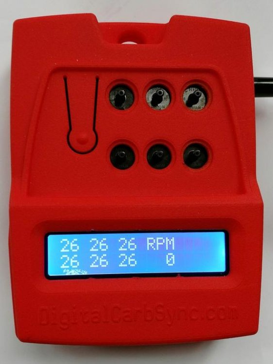

I'll start bringing this up to date now that I have a tour deluxe to experiment on. I'll be looking for lessons learned from others syncing their second gen engines.
Need to refine the RPM feature. It's a contest between responsiveness and jitter. I sold my 89 before I got it exactly the way I thought it needed to be.
If any of you who built or bought one I can make the experimental software version available. Just contact me on digital carb sync dot com here.
