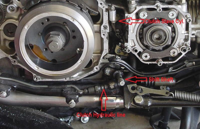

azxvz1284 Posted November 19, 2014 Posted November 19, 2014 Okay Guys, time again for your help; I replaced the stator cover with another from Ebay; but FIRST welded the sides of the single support on the backside for the shaft's tunnel through the stator. Changed the oil using 5W-30; as it's already in the 30-40 degree temperatures with Winter almost here. Flush, filled and bled the clutch with Valvoline Synthetic DOT 3 fluid. The motor is running great. but, here's the prob; No matter how much I tweak the shift linkage, moving through the gears is tricky. One moment getting into first is really easy, the next moment it's not. Same with the other gears. The toe of the shift goes down to change a gear, and it bangs against the rider's left floorboard. Same with the heel. I could try cutting 1/2 inch off of the 'inside' floorboard along its length so the heel-toe piece won't 'bottom out', but I must be missing something. I wondered if it is a bushing missing from where the shaft goes through the Stator's tunnel, but the shaft was already a tight fit through it. About a 1/2 to 1" of the smooth part of the shaft is visible before the knurled portion the shifter linkage is attached. What could I have missed? Any suggestions? Again, thanks in advance. Richard in Arizona

azxvz1284 Posted November 27, 2014 Author Posted November 27, 2014 Well, machisas mas gracias to Videoarizona, as the 20w-50 was an near-instant resolution. But, there is a little clutch-lever fluid (Dot 3) coming out of the shifter shaft hole in the stator cover. Also, there is some 'slop' in the shaft, where it comes out of the stator hole; not laterally, but in-and-out of the stator's shaft hole, with about 3/4 of an inch of play. Any thoughts on these two points? Thanks again, RIchard in Prescott Valley, AZ Richard in
Venturous Randy Posted November 27, 2014 Posted November 27, 2014 If you are having brake fluid coming out your shifter linkage, I suspect the master or a hose is leaking and migrating down a wire or something to the linkage. As far as the in and out slop, there should be "C" clips and washers to minimize this. RandyA

Prairiehammer Posted November 28, 2014 Posted November 28, 2014 ...there is a little clutch-lever fluid (Dot 3) coming out of the shifter shaft hole in the stator cover. If the fluid you observe is actually brake/clutch fluid, then you may, (but unlikely) have compromised steel hydraulic line or the hydraulic hose from the steel line to the slave cylinder is leaking or the slave cylinder is leaking. However, the fluid is probably just residual DOT3 from previous attempts at bleeding the clutch hydraulic system.
