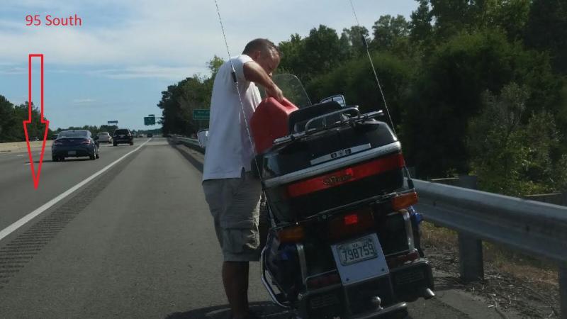

Droneh8tr Posted November 13, 2014 Author Posted November 13, 2014 Thanks everyone.. I'll need to tweak the fuel level sensor to reflect more accurately.. I had a bar on the indicator and ran out on the highway.. My wife had to come save me.. She even took a pic..

Droneh8tr Posted November 14, 2014 Author Posted November 14, 2014 And??? All right all right.... You two jumped on wanting proof of my pain quick.. The wife didn't even get out of the car..
Venturous Randy Posted November 14, 2014 Posted November 14, 2014 Is your bike an 83 or an 85? You appear to have an 85 or MKII trunk on it. RandyA
Droneh8tr Posted November 14, 2014 Author Posted November 14, 2014 Is your bike an 83 or an 85? You appear to have an 85 or MKII trunk on it. RandyA No its an 83.. the PO mounted a different Trunk.. I have the 83 trunk, I just don't use it.
