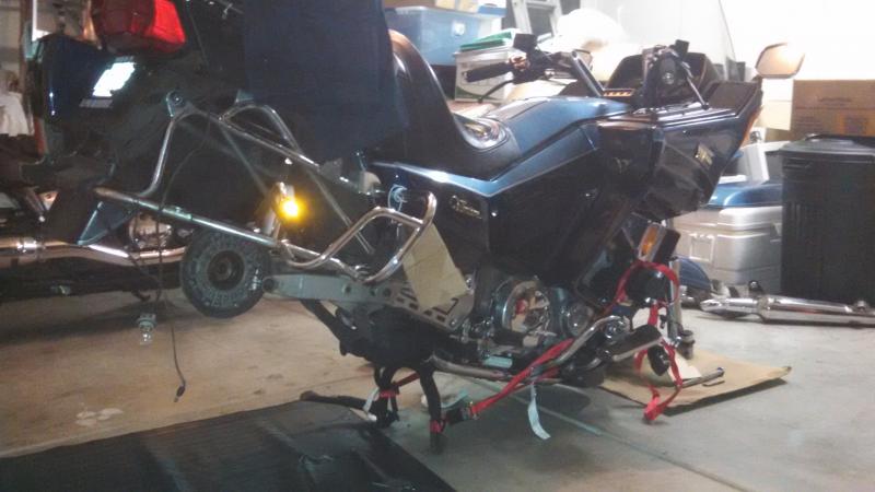

Condor Posted April 7, 2015 #23 Posted April 7, 2015 Leland said: I have a center stand, but don't see how you could remove the rear wheel with it. Whenever I change my tires, I remove the center stand and install Carbon one's lift adapter (easy). You have to lift the bike pretty high to remove the rear wheel. Now if the rear fender was hinged like the old Harleys then you could do it. A few years ago one of the members posted how to remove the rear tire on a center stand by removing the front tire first and setting down on the forks. Wonder what happened to that post?? Maybe it's still somewhere on the board???
videoarizona Posted April 7, 2015 #24 Posted April 7, 2015 Hmmm...should be since I used that post to remove my rear wheel on my 1st Gen. I'll look....
videoarizona Posted April 7, 2015 #25 Posted April 7, 2015 http://www.venturerider.org/forum/showthread.php?1393-Rear-Wheel-Removal Multiple ways of removing wheel....
