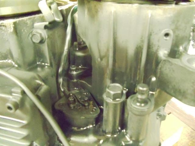

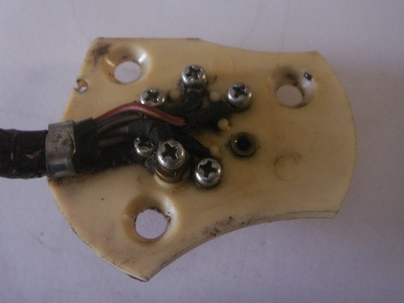

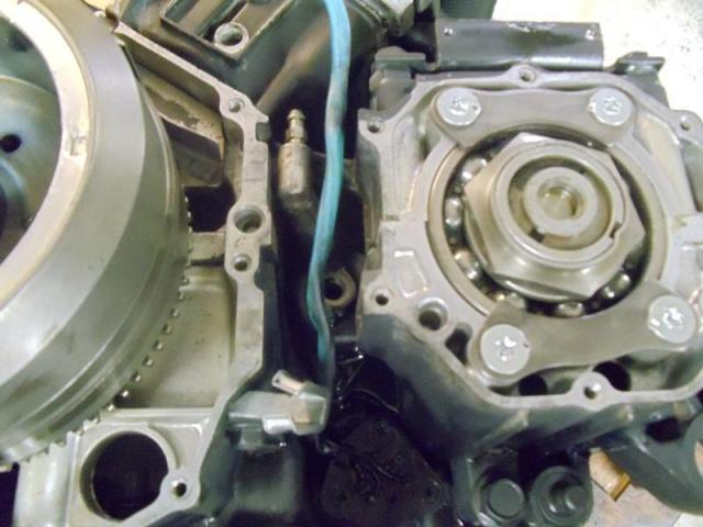

Prairiehammer Posted October 10, 2014 Posted October 10, 2014 Is this what you are looking at as the leak? There is an O-ring around that phenolic looking switch. Usually it is orange (the O-ring). Some have experienced a leak at that switch, because the white phenolic looking thing was cracked. You will also probably require a new middle gear cover gasket as well. And don't forget the copper sealing washer on the bolt at 6 o'clock on the middle gear cover.
videoarizona Posted October 10, 2014 Author Posted October 10, 2014 That's it! OK...now I know what is ahead. Really appreciate the pictures too! Thank you, Kevin!
Prairiehammer Posted October 11, 2014 Posted October 11, 2014 One caveat: the clutch slave cylinder can leak as well, confusing one as to the source of the leak. Just sayin'.
