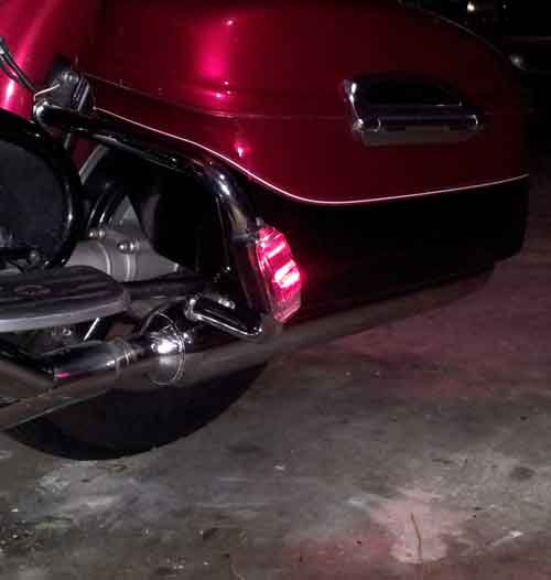

Tensilon Posted September 30, 2014 Posted September 30, 2014 My bike is not an RSV it is a RSMTD however, I did install LED side marker lights to both front and back reflectors which have both running and turn signal functions. Looks stock until you turn on the key, then they are way bright. Definitely good to have some lights on the side of the bike in addition to the front and back. Cost me all of $20 for the LED's off of Ebay. Have some install pics if you are interested. Here is a few pics of the bike lighted up in the garage with the door shut. Larry....
