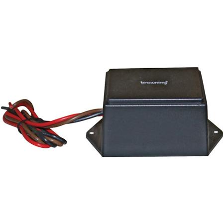

syscrusher Posted July 27, 2015 Author #7 Posted July 27, 2015 It's a three terminal device, Power In, Filtered Power Out, and Ground. Since I had already modified my fusebox I put this between the existing ACC connection to the fusebox and the right side of the ACC fuse. This required one blue shielded tab connector for the output connection to the ACC screw terminal, a blue shielded female tab receptacle to connect the right side of the ACC fuse to the input, and a ring connector to screw down to the ground screw terminal. It screwed to the top of the air box right up near the battery. My entire ACC load is filtered clean as Taylor Swift's teeth and there is no unwanted noise whatsoever. Accept no substitutes, this is the real deal with real components inside it. It deserves five stars, the people giving it a so-so review on Amazon didn't know how to install it. Browning BR-FILTER

syscrusher Posted July 28, 2015 Author #9 Posted July 28, 2015 (edited) djh3 said: Here are some others. Noise suppressor 1 This is like the one I installed. I'm happy that the Pyramid worked for you. I took a pass on it when I read a reviewer on Amazon who said he cut one open and there was tiny thin wires and next to nothing in the way of components. The Browning has some heft, rated for 250W with a 10000 mfd capacitor and iron core inductor. Radio Shack used to sell one like the first link you provided, it's transformer isolation for the signal path and losses can be severe if the overall impedance match is very different. Edited July 28, 2015 by syscrusher photo
