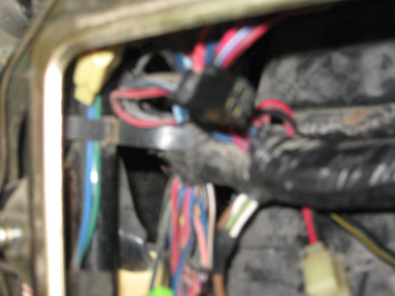

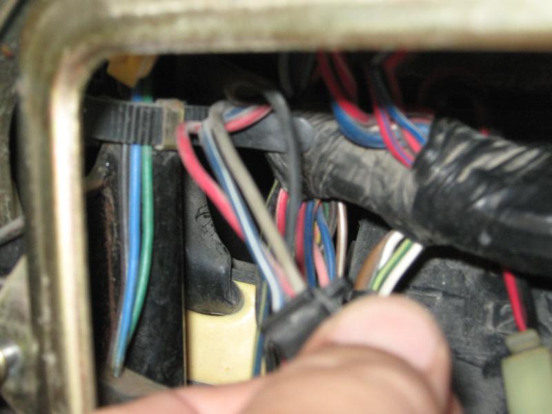

rbig1 Posted September 15, 2014 Author #27 Posted September 15, 2014 well what is this one with blue connector the one that says oem side stand. so now there is tf307 relay not in 83 wiring diagram may be wrong diagram in tec section don't think there is a gear indicator in 83:doh:
Neil86 Posted September 15, 2014 #28 Posted September 15, 2014 Rodney... all I'm saying is in my 83 service manual they show one blue/white wire from pump relay coil going to tipover switch, a black/white from interlock system with a diode going to tipover switch too. Without the diode you could feed power from the pump relay back into TCI or into sidestand relay. Your diode may have failed causing the fuel pump relay to open randomly. In newer bikes (84-up) they redid the wiring so the tipover switch kills ignition, then #2 coil ground (gray) no longer cycles and the fuel pump relay opens killing pump.
