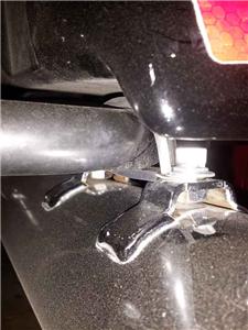

Condor Posted February 3, 2018 Posted February 3, 2018 Here's the pic on one schematic, and some other styles as well....
