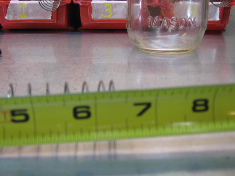

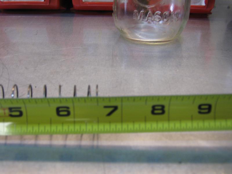

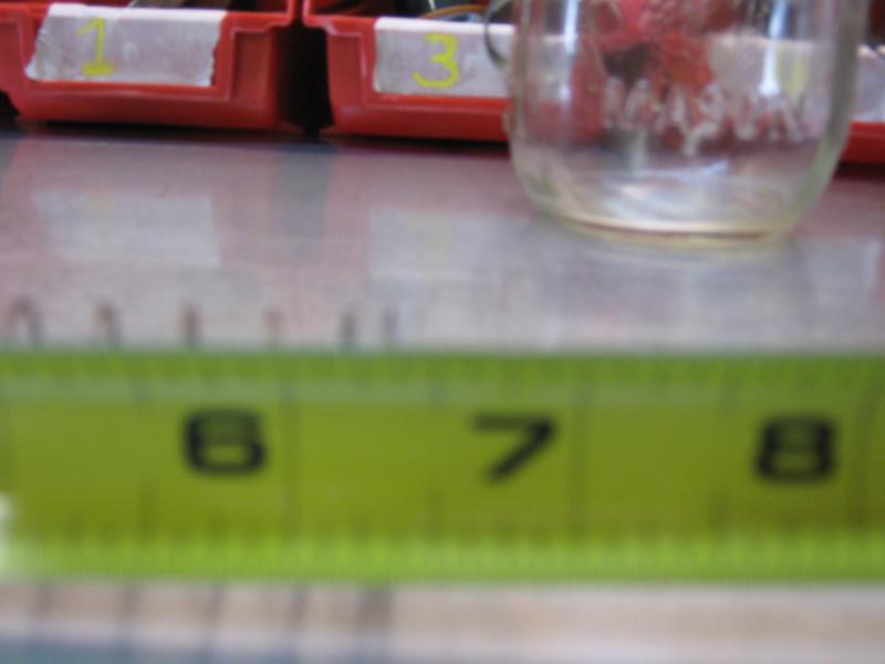

rbig1 Posted August 22, 2014 Author #20 Posted August 22, 2014 well removed carbs today. has any one said inside pull cable stinks. got me trusty mason jar and drained each carb aprox 1oz fuel except #3 a bought 1/3 less. lots of floaters in fuel, number 3 had grains real fine. also #3 small jet on top was covered with black goo. this was probably due to air box clamp in wrong spot. may have been main cause. just guessing. I never caught it. the slide in 3 was a little sticky also. all 4 of the mixture screws are stuck tight. pulled all slides the springs are different length diaphragm. will try to post pics. cant work on it any more this week.
