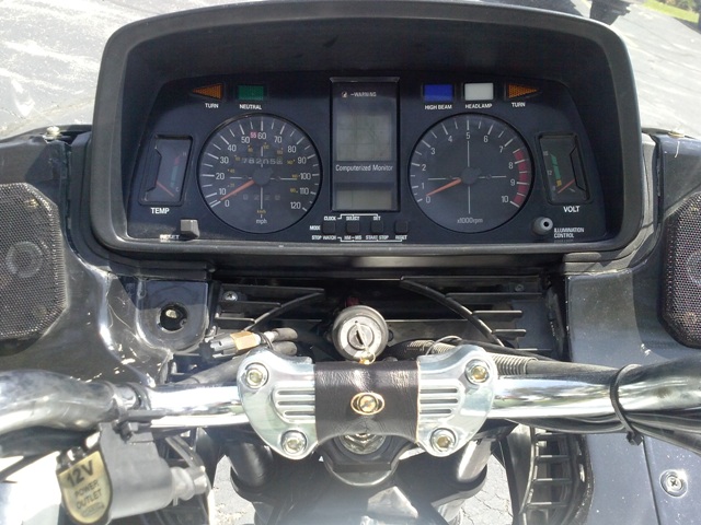

As for handlebars, I have a set off a Maxim 650 that I tweaked the bends to be a little more to where I wanted it. I had started off with them mounted right off the triple tree, but I found a HD riser that lifted them about 4" and pulled back about 1". Had to use shims because the HD clamp was for 1" handlebars and mine were 7/8". All in all, mine are maybe not everyones cup of tea, but the bike is really comfortable, especially with the floorboards and backrest. Any other questions or more pics, just ask.
-Andrew
Pic #1: Handlebar clamps from a XS650 or the like. I removed all the hardware from the Venture and inserted thru the holes on the upper tree. Used a spacer because the non-threaded part was longer than the tree was thick.
Pic #2 & 3: Handlebars mounted.
Pic #4 & 5: Found a HD riser cheap on cl, because the handlebars didn't reach back as far as I wanted. This put them right where I wanted them.
Pic #6: Had to cut the top of the clamp, because the HD mounting for the risers was closer together than the Venture. Just covered with a scrap of leather and made it a custom one-off. Oh, my bike never had the circle thingy that was around the base of handlebars, in case you're wondering why it isn't there.
