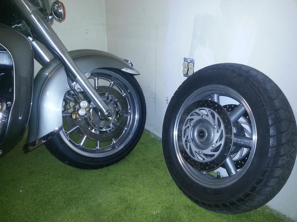

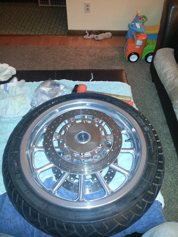

BratmanXj Posted March 16, 2016 #9 Posted March 16, 2016 As it's on the throttle side it might have something to do with compensating for the rotational forces of the drive shaft on the clutch side of the bike. I removed the covers when I was still running the stock front wheel and did not notice anything odd with the way the bike handled or tracked. I have since switched to the 18" wheel of a Stratoliner that came with floating rotors and a smaller "insert" weight rather than the disk/cover. I did install the weight on the 18" but yet again did not notice anything significantly different.

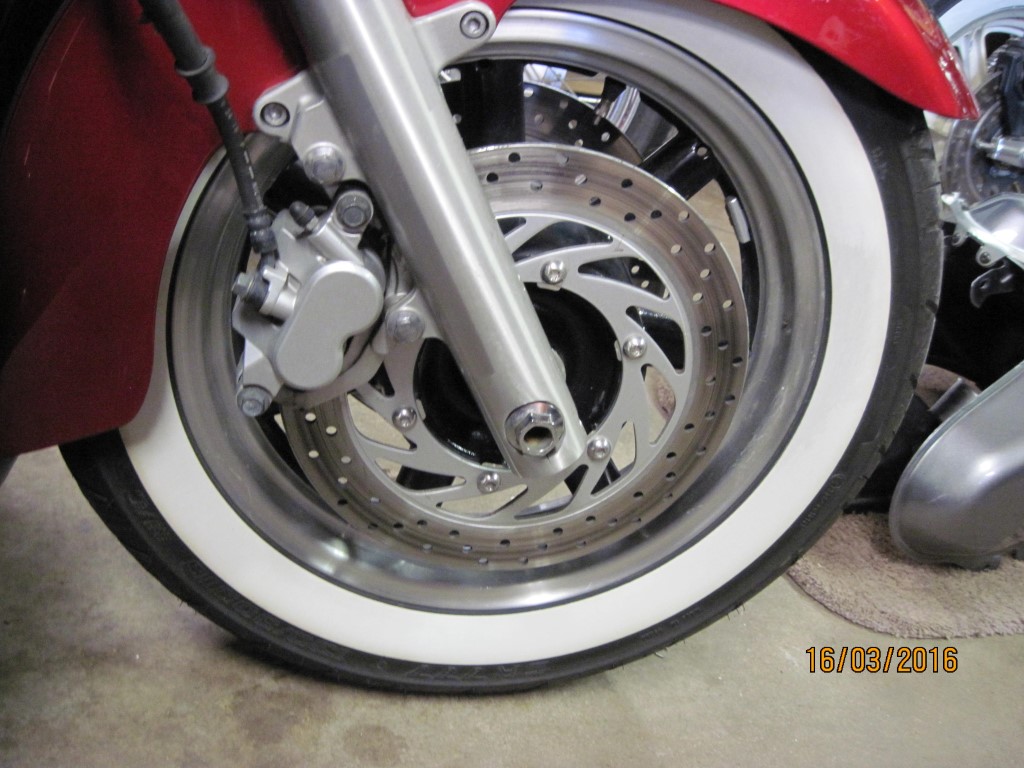

eagleeye Posted March 16, 2016 #10 Posted March 16, 2016 One of these good old threads: Yeah, that could be, but I don't know and Haven't heard from anyone who actually does. I took mine off years ago, and like everyone else who did, noticed no difference. Here is a pic for those of you who want to know what those gorgeous machined discs look like:

BratmanXj Posted July 28, 2016 #21 Posted July 28, 2016 DblTrbl said: I like the look without the covers. I may do that next time if I can find some Chrome Rotors. Anyone have an idea where I can locate a set? I had my front wheel chromed and think it would look better with the matching rotors. Stratoliner S models came with chrome floating rotors, I did a full 18" wheel & rotor swap a few years back on my Venture.

BratmanXj Posted July 28, 2016 #23 Posted July 28, 2016 Freebird said: I really like the looks of that wheel on our bike and I've found a few on the market but none that I've found come with the rotors or those covers. Add the price of the rotors and covers and they get expensive real fast. Still keeping my eyes open for a fair deal. I stumbled on a hell-of-a-deal when I found the wheel, rotors & cover with blown out bearings on eBay in late fall of '14. I was due for a new front tire anyways. Lets just say (doing my own labor) it cost me less than most people pay a shop for a tire & mount.
gggGary Posted July 28, 2016 #24 Posted July 28, 2016 BratmanXj said: `18" stratoliner wheel What tire do you have on there? Was it plug a play or was there dome "fiddling" Any comments on handling before and after? Will the existing rotors bolt on that wheel?
