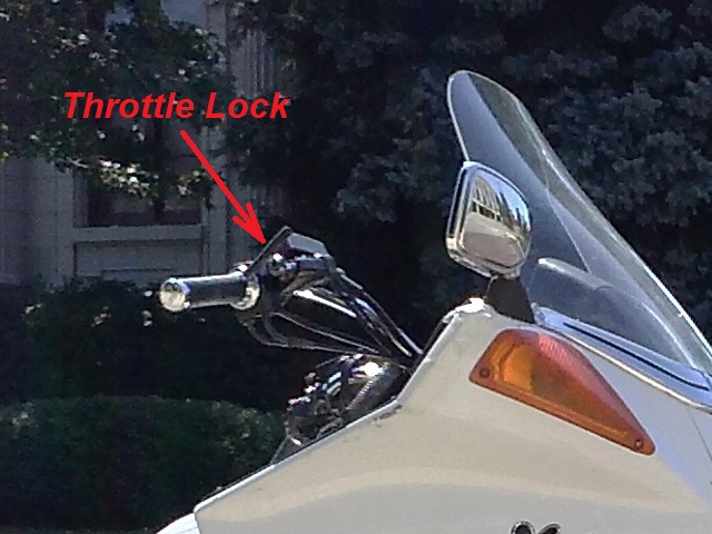

Wanderer Posted March 5, 2014 #1 Posted March 5, 2014 Guys this couldn't have been simpler. It may not be the perfect throttle lock, but it looks fairly good and costs $1.25. Okay, I was wanderering around Fred's (dollar store) and found a single pole sign holder. Sorry I meant to take a before picture, but its a rod that has two loops about 9" apart. Since I had already cut it, that's me holding it together. Hope you can see what I'm talking about. And the finished product after cutting one loop off and bending to final shape with my large Channel Locks. Took all of 5 minutes for project. 1: Sign holder with the two loops - $2.50 2: Makes two throttle locks at a cost of $1.25 each.

Wanderer Posted March 5, 2014 Author #7 Posted March 5, 2014 icebrrg3rd said: Made mine out of a wire coat hanger and a scrap of vacuum line over it- $0 It's nice for relaxing your grip for a minute or so. Over bumps it does slip, plus when not in use it sticks up. I'd like a better one, but for free, I'm running it til I get my CC. -Andrew Thanks for posting. It makes what I'm going to say easier. I'm ashamed to admit it, but I was so sure it was going to work I didn't test it prior to submission. It may be my standard grips or the tensile strength of the wire, but it vibrates down pretty rapidly. I do think if I can get a rubber ring up on the chrome part of the grip and put it over that it will work. I think I've got an old bike tube here somewhere that should work for that. I'm so sorry I'll get back to you on this issue.

Wanderer Posted March 5, 2014 Author #9 Posted March 5, 2014 I'm back! I think a rubber ring is the answer. I used electricians tape up on the chrome section of the grip and the cruise control worked flawlessly. However: we know how long electrical tape is going to last. I didn't have that old tube, so I'm gonna have to look around for a piece of rubber and test it again. I didn't fail I only had a couple of things so far that didn't work.

Wanderer Posted March 10, 2014 Author #12 Posted March 10, 2014 Pulled the tube out of the wifes bike and cut a piece 2" wide. The hard part was getting my looped rod over the rubber, what a PITA, but with a little persistence and a small dull screw driver I worked around until it was under. It works ike a champ. Takes a pretty good pressure from the thumb to force down on the brake lever, but I'm a happy camper.
