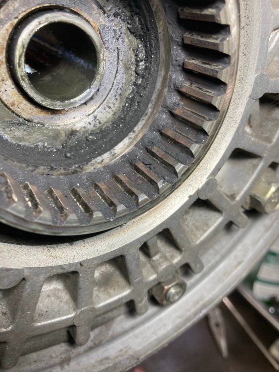

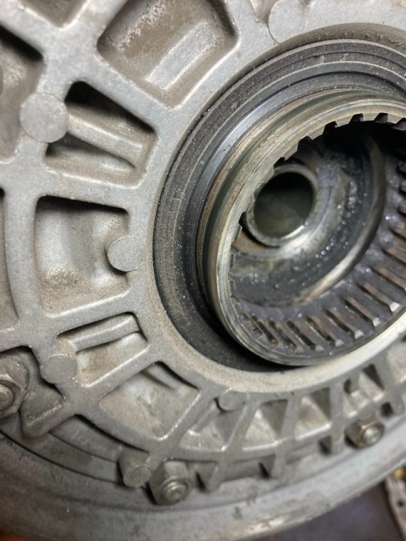

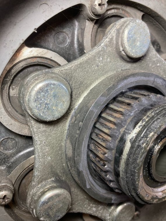

Geobob Posted January 15, 2021 #29 Posted January 15, 2021 So here we are again. Glad to find the thread again. So last summer I had to replace my differential and maybe the drive side because again it looked worn. This thread documents my previous drive side replacement in 2018. I can say the Honda Molly paste or what ever it is technically called does not work. Maybe the poster was correct that this product is an assembly lube and not spline grease. It was recommended by my local shop owner whom I trust but clearly it is not cutting it (see photos). I am going to try the Sta-Lube product this time. It is very interesting to learn of the heat build up. I never gave that much thought but it looks to me like this grease is getting baked. So the conclusion is that some differentials run cooler than others and age or wear and tear might be the cause. This make sense since this problem did not present it self when the bike was much newer. So maybe I should look at rebuilding one of these differentials to remedy the heat build up problem.
Marcarl Posted January 16, 2021 #30 Posted January 16, 2021 I'm no expert here, but what you are showing is the pictures reflects the issues I had on my 85, until I went with Lucas Extreme, that solved the isssues.
Geobob Posted January 16, 2021 #31 Posted January 16, 2021 I picked up some Sta-Lube. I think both products will work better than the honda molly past. I also found out tonight that you can pry like hell for a good 15 minutes and they splines will not lift off the wheel without removing the snap ring on the top. Lube up the pins and got the wheel ready to go back on.
Marcarl Posted January 16, 2021 #32 Posted January 16, 2021 10 hours ago, Geobob said: I also found out tonight that you can pry like hell for a good 15 minutes and they splines will not lift off the wheel without removing the snap ring on the top. No kidding,?, You too eh? Funny how that works,,,, had me totally kerbaffled the first time.
