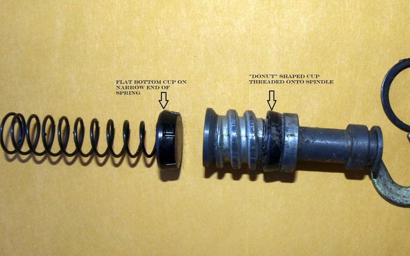

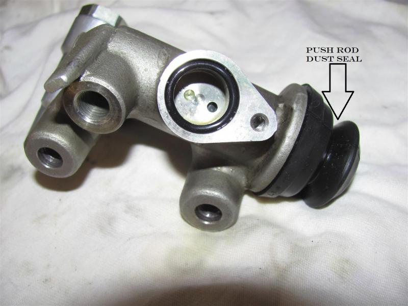

mcgyverit Posted February 14, 2015 Author #69 Posted February 14, 2015 received the rear rebuild kit finally and swapped parts out and assembled. only issue I had was now that the whole assembly is working the way it is supposed to it is a lot harder to assemble the snap ring while fighting the spring the other issue I had was the rebuild kit gives a cylinder cup that shows it going on the end of the cylinder, but I don't think that is needed as the piston from the brake pedal would go up inside the cylinder. any thoughts? removed the rear brake caliper to make sure the pistons move as they are supposed to, but need to read up some more on that process. seeing as the rear was all gummed up from sitting I went ahead and ordered a front rebuild kit as well and will begin the process of rebuilding it as well.
Prairiehammer Posted February 14, 2015 #70 Posted February 14, 2015 the other issue I had was the rebuild kit gives a cylinder cup that shows it going on the end of the cylinder, but I don't think that is needed as the piston from the brake pedal would go up inside the cylinder. any thoughts? Are you talking about the dust seal boot here: If so, yes it is needed. For the obvious purpose to keep dirt from the master cylinder innards and for the less obvious purpose to keep the brake pushrod from flopping around and possibly getting mis-positioned. I gotta ask: why would you even consider not using all the parts, especially on something as critical as the brakes?
mcgyverit Posted February 14, 2015 Author #71 Posted February 14, 2015 Prairiehammer, it is the small cup that goes on the end of the cylinder inside the dust boot. at least that is the way the diagram shows (and I am interpreting) on the manual
Prairiehammer Posted February 14, 2015 #72 Posted February 14, 2015 Prairiehammer, it is the small cup that goes on the end of the cylinder inside the dust boot. at least that is the way the diagram shows (and I am interpreting) on the manual Here is a pic of a disassembled master cylinder: Notice the "small cup" (the donut shaped one) must be threaded onto the spindle.
mcgyverit Posted February 14, 2015 Author #73 Posted February 14, 2015 thanks for the pics! clears that up for me.
