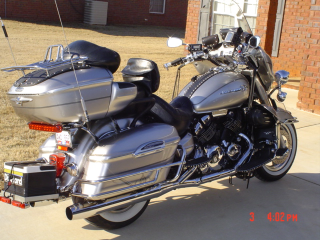

Eck Posted January 29, 2014 Posted January 29, 2014 (edited) Appears you have the confidence you need based on your maintenance skills. I will add my 2 cents: The RSV is a very top heavy bike and in slow motion, is hard to hold up / control. Be careful I would definitely do the ignition by-pass mod ASAP...it is a very well know problem. Check to see if the rear shock is leaking. Lay on floor and pull up on rubber boot to visually check for presence of any oil. If so have the dealer replace it before you buy it. Check goose neck bearing adjustment. This is an easy fix that you can do yourself. Remove, clean up, and re-lube drive shaft and rear splines If I can be of any help with maintenance questions feel free to email me here on the site or you can call me at two five 6 - four 29 - eight six 23. I owned an 05 RSV fro about 5 years and I really enjoyed that bike. (see pic attached below) Edited January 29, 2014 by Eck

The Tooch Posted January 30, 2014 Posted January 30, 2014 I owned an 05 RSV fro about 5 years and I really enjoyed that bike. (see pic attached below) Hi Eck I've been thinking of putting the white walls on my 05 for that old school look but wasn't sure. Thanks for that picture, they look great! Who makes those do you remember and were they the stock size? Thanks Dave.
Yammer Dan Posted January 30, 2014 Posted January 30, 2014 You a Sea-Foam fan?? Taking bags off 1st time is a itch. But that V-4 is sweet.

rutman Posted January 31, 2014 Posted January 31, 2014 You a Sea-Foam fan?? Taking bags off 1st time is a itch. But that V-4 is sweet. why is that?
Eck Posted January 31, 2014 Posted January 31, 2014 Hi Eck Who makes those do you remember and were they the stock size? Thanks Dave Dave, I sent you an email....I didn't want to hack this thread..
