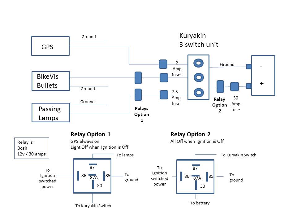

Bert2006 Posted January 24, 2014 Author Posted January 24, 2014 (edited) Ok, I have drawn a diagram that has two options for locating the Relay. It would be either/or - Option 1 allows to keep the GPS on when ignition is off. (2 relays) Option 2 shuts everything off with ignition. I am on the right path? (1 relay) May go with option 2 and simply keep the GPS wired directly to the battery, this way I cannot accidentally drain battery and have a spare switch for later use. Are my relay drawings and proposed conections correct? Thanks Edited March 12, 2016 by Bert2006

Bert2006 Posted January 24, 2014 Author Posted January 24, 2014 Kik - see new question and diagram...in my last post -just looking to see if my wiring plan is correct as well as my connection points for the relay. Going with option 2 . Thanks

wes0778 Posted January 24, 2014 Posted January 24, 2014 Just my but if you are using LEDs for passing lights, I wouldn't even bother with relay option 1.
Bert2006 Posted January 24, 2014 Author Posted January 24, 2014 Just my but if you are using LEDs for passing lights, I wouldn't even bother with relay option 1. I am going with option 2. My remaining question is if I have my relay conections figured out right for that option in my diagram. I was planning to use the ignition switched wire that currently powers the passing lamps from the headlights to trigger the relay. Would you be able to tell me if my relay plan is correct and if that would work. Thanks:thumbsup:
