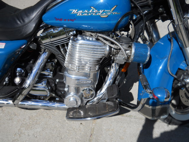

cowpuc Posted December 7, 2013 #4 Posted December 7, 2013 Hi Barry Yep, have owned, modded, resold and ridden several of them.. Also helped repair lots of them on the sturgis route touring over the years. Although NOT an expert on HD by any means so I am sure others will have different opinions.. Here is a pic of one I did up with a supercharger on it.. NICE BIKES!! Very rideable! Handle the twisties just great - lots of fun!! If its a stage one it would probably dyno in the 70 horse range. Good brakes. GREAT dealership support cause its a Harley - LOTS of dealerships all across the country.. That being said though, being an 02 there are parts that are probably already obsoulete - especially tuners and such.. I have found that the twin cam motor from HD is the most durable motor HD has made to date. Yours would be the 88 inch motor, cant remember if they offered a carb model back than, its probably FI.. Back in that time frame (and I think it was before the 02's) HD had troubles with the FI, than they switched to Delphi. If its not carbed I am sure you are getting the delphi.. Weak points,, the cams and oil pump are chain driven. There is a small plastic shoe that serves as a tensioner on this system. This little shoe has caused alot of grief for lots of folks, mainly folks who don't believe in real maintenance.. As the shoe wears it can contaminate the oil.. Also if not replaced on time it can cause catastrophic failure.. I worked on three HD's year before last that had this happen out at the sturgis rally - none of the folks I helped even had a clue of what happened.. In my opinion this little shoe is the achellies heal of the twin cam.. They are usually good to 25 thousandish and it sounds like the bike your looking at is under this BUT I would replace it soon if I bought it.. Personally, I think the aftermarket gear driven cam setup being offered for this is the ultimate solution (that blower was gear driven) but its pricey - about 550 bucks - and makes a whine (sounds like our clutch noises).. The TC motor and tranny is also now "modular". The evo's/shovels/pans had the engines separated from the trannys - held by a backing plate. The TC trannys are bolted onto the engine BUT there is still a primary chain that drives the tranny. HD now uses an automatic adjuster, again with a small plastic shoe on it. That system has caused some issues too and I personally know guys who have gone back to the old manual adjust system with good success.. One of the really neat things about HD is the VAST amount of performance parts and pieces available for gear heads.. They are VERY buildable BUT I have found out that if left alone these TC's are very capable of thousands of miles!! Puc
