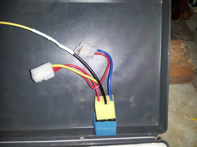

djh3 Posted December 29, 2013 #27 Posted December 29, 2013 OK did my research and ordered up som parts to make some ignition switch relay by-pass. I made them plug and play. If your interested I should be able to get one to ya $20 shipped.
jonesy Posted December 29, 2013 #28 Posted December 29, 2013 OK did my research and ordered up som parts to make some ignition switch relay by-pass. I made them plug and play. If your interested I should be able to get one to ya $20 shipped. PM sent, I'll take one.
aharbi Posted January 18, 2014 #30 Posted January 18, 2014 Thanks djh3, got mine today. Looks good professional job, heat shrink and no exposed connections/wires. It would of cost me at least that much chasing down the parts to make one. Like you said plug/play couldn't be easier.
djh3 Posted February 22, 2014 #31 Posted February 22, 2014 I have had real good response off the Delphi board. A few guys here have bought them also. Thanks for the support. I guess I need to see if I can list them on the page where members sell things. Dont know how to go about that though. Also I am able to make the ECM by pass. All you have to do to make the system "keyless" should the switch fry out is install a toggle switch. Most folks though tell me once you install the by-pass relay you wont have a problem, it sort of solves its self.
