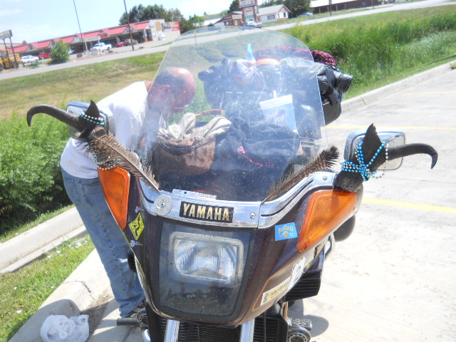

Cheap Harbor Freight Woo Loo lasted 6 winters on this Roadstar in the snowbelt of Lake Effect snow Ohio. It's still going. And since I got the Venture, it will STILL be my Winter bike.
