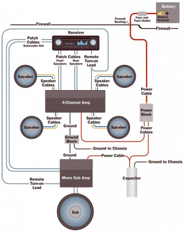

ericdg16 Posted June 20, 2013 #1 Posted June 20, 2013 I am trying to install an alpine 4 channel amp in my 05 rsv. I was reading how to install an amp in the Tech section and am a little confused about the rear speakers. In the tech article, if I'm reading it right, it says the rear speakers are running on the same channel. So if I'm thinking right I need to run new wires from each speaker to the seperate channels on the amp. Because, if I connect to the rear speaker wires where they exit the stereo I would be using only 3 channels? One each for the front speakers and one for the rear.
Seaking Posted June 20, 2013 #2 Posted June 20, 2013 ericdg16 said: I am trying to install an alpine 4 channel amp in my 05 rsv. I was reading how to install an amp in the Tech section and am a little confused about the rear speakers. In the tech article, if I'm reading it right, it says the rear speakers are running on the same channel. So if I'm thinking right I need to run new wires from each speaker to the seperate channels on the amp. Because, if I connect to the rear speaker wires where they exit the stereo I would be using only 3 channels? One each for the front speakers and one for the rear. The rear speakers are stereo, not mono.. I just recently installed an alpine 45W amp and just connecting the wires in the proper spot under the front fairing will do the trick.. no need to run new wires to the rear.. stereo front and rear. I hadn't had the time to do the wiring write up on it but do have my notes here.. If your stock wiring matches mine it should be an easy hook up. I'll see if I can dig up my notes and send you an email.. Been running the amp since early march and the sound is awesome.. Cheers
ericdg16 Posted June 20, 2013 Author #3 Posted June 20, 2013 awesome thanks.....sounds like we're probably running the same amp. Just out of curiosity where did you install your amp under the front fairing? I've made brackets to install mine just below the stereo on that lower metal frame.
ragtop69gs Posted June 20, 2013 #4 Posted June 20, 2013 Seaking said: The rear speakers are stereo, not mono.. I just recently installed an alpine 45W amp and just connecting the wires in the proper spot under the front fairing will do the trick.. no need to run new wires to the rear.. stereo front and rear. I hadn't had the time to do the wiring write up on it but do have my notes here.. If your stock wiring matches mine it should be an easy hook up. I'll see if I can dig up my notes and send you an email.. Been running the amp since early march and the sound is awesome.. Cheers If you would, I'd like a copy of that email. I have an amp sitting here but have been a bit apprehensive about doing the install and your notes along with the tech article may be enough for this electrical dummy. What speakers you using ? I have Polks in all 4 corners.
