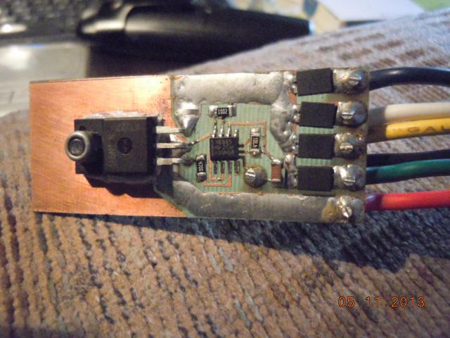

Flyinfool Posted May 11, 2013 Author Posted May 11, 2013 (edited) Progress!!!! Here is a pic of the first finished PCB for the horn flasher. Now to install it on the bike........ Edited January 8, 2017 by Freebird
Flyinfool Posted May 12, 2013 Author Posted May 12, 2013 Well it was getting a little warmer than what I like. I thought that since this is for very short intermittent use that I could get away with just using the ground plane copper on the board for a heat sink. I will need a little more heat sink than that. It is borderline OK but borderline is never good enough for me. With the full load of the bikes lights, It got to the point of being uncomfortable to touch (about 140 F) after about 30 seconds. I will get a small aluminum heat sink to add and it will be fine. I doubt I will ever lay on the horn for more than 30 seconds at a time.
