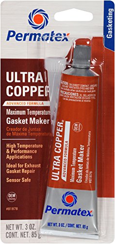

syscrusher Posted November 19, 2015 #29 Posted November 19, 2015 Even if it fit really nice I would still get some Permatex Ultra Copper Maximum Heat Gasket RTV and use it as installation lube.
garyS-NJ Posted November 19, 2015 #30 Posted November 19, 2015 Thanks, I have ultra copper and thought it might make it too difficult to pull the pipes. Guess I can put it on just the muffler side and see.. And add it to the collector side if necessary.. Even if it fit really nice I would still get some Permatex Ultra Copper Maximum Heat Gasket RTV and use it as installation lube. [ATTACH=CONFIG]102366[/ATTACH]
syscrusher Posted November 20, 2015 #31 Posted November 20, 2015 Thanks, I have ultra copper and thought it might make it too difficult to pull the pipes. Guess I can put it on just the muffler side and see.. And add it to the collector side if necessary.. Maybe make it difficult to pull pipes buy my experience was different. I had FMF Q2 muffler on my DR650 but instead of repacking I decided to go with a Gixxer can. The FMF install had me using the Ultra Copper to seal between headpipe and muffler pipe. I don't recall any particularly gnarly procedures to separate those when I put on the Gixxer can and I think I used Ultra Copper again to mount it. Could be my memory is faulty and YMMV but I would rather have it work well and not leak even if it was slightly more difficult to remove. And yes, the Q2 is for sale if anyone wants one. I also have a complete 2002 GSXR1000 exhaust set, minus can, if anyone has been looking........
