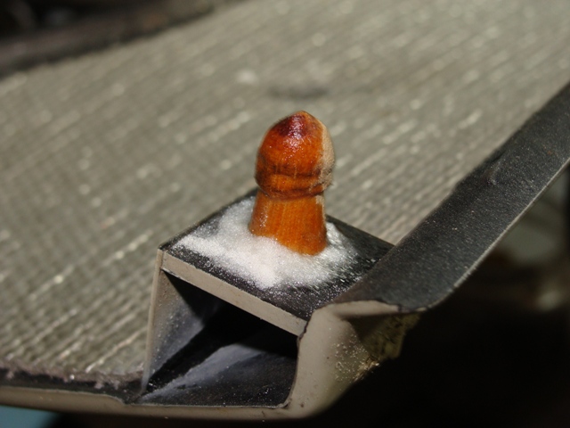

van avery Posted December 5, 2012 #4 Posted December 5, 2012 I fixed mine with a piece of dowel sanded to the right form, then glued to the side cover with Rapid-Fix. Did it back in Feb and has worked great every since.
SilvrT Posted December 5, 2012 Author #5 Posted December 5, 2012 van avery said: I fixed mine with a piece of dowel sanded to the right form, then glued to the side cover with Rapid-Fix. Did it back in Feb and has worked great every since. Good idea!
