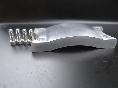

camos Posted August 9, 2016 Posted August 9, 2016 I know this an old thread but here goes.. On my '84 Venture I have a high speed weave snaking instability. This with new tires (shinko 777's), progressive springs, neck bearing adjusted,.. Got to check that rear shock bushings and swingarm bearings tomorrow but figure I should get a superbrace, or a condorbrace, or a Bob Meyers VZ Brace... But the Superbrace is now up to $160 so I'm trying to get a lower price.. There's plenty of stock fork braces on ebay so I'm figuring many people are installing super braces.. suggestions?I bought one like this a few years ago. It was about half the thickness of the Super Brace and about twice the thickness of the OEM brace and cost about half of what the Super Brace did. The OEM brace is anaemic and the Super Brace is excessive while this brace is just right. That's my opinion at least.
garyS-NJ Posted August 9, 2016 Posted August 9, 2016 I bought one like this a few years ago. It was about half the thickness of the Super Brace and about twice the thickness of the OEM brace and cost about half of what the Super Brace did. The OEM brace is anaemic and the Super Brace is excessive while this brace is just right. That's my opinion at least. Nice and the only one like it on eBay.. Do you know the mfr? Sent from my VS987 using Tapatalk
camos Posted August 9, 2016 Posted August 9, 2016 Nice and the only one like it on eBay.. Do you know the mfr? Sent from my VS987 using TapatalkNo, I never knew who made them. All I can say is the brace was made from aircraft aluminum and fit perfectly. I've seen this type of brace on several member's bikes. Condor made a brace for a while that was similar but better looking, a bit more curvy.

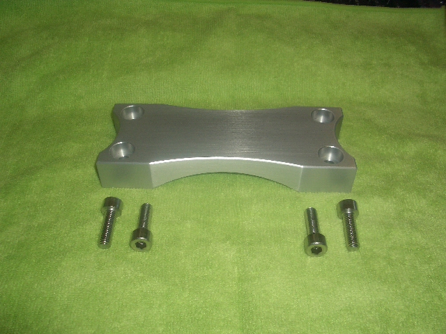

syscrusher Posted August 11, 2016 Posted August 11, 2016 I bought this one a year or two ago but this person doesn't seem to be selling it anymore on Ebay. It's very "chunky" and worth trying to find IMHO: http://www.ebay.com/itm/Yamaha-Venture-Fork-Brace-1983-1993-/261203137975?hash=item3cd0eb95b7&nma=true&si=GZRXGDkeNvQiYq%252FaIb%252BR9nMe6fw%253D&orig_cvip=true&rt=nc&_trksid=p2047675.l2557
Condor Posted August 11, 2016 Posted August 11, 2016 That's a nice looking brace. With the design shape it probably was done on a water jet. The brace I had for the group buy was a CNC and flatter.
Flyinfool Posted August 11, 2016 Posted August 11, 2016 I bought one like this a few years ago. It was about half the thickness of the Super Brace and about twice the thickness of the OEM brace and cost about half of what the Super Brace did. The OEM brace is anaemic and the Super Brace is excessive while this brace is just right. That's my opinion at least. This one looks like it is made from a sand casting. On the inside part that is against the fender it looks like a sand cast surface that did not quite clean up during machining and even on the top machined surface you can see a couple of holes from air pockets or inclusions. Since the purpose is adding strength and stiffness to the front forks I would want one machined from a solid bar. I have one on my bike but i got it so long ago I don't remember where it came from. But it did and still does help. I always get a kick out of ads that try to make something sound better by saying "Aircraft grade aluminum" there are some really weak grades of metal used on aircraft.
Patmac6075 Posted August 12, 2016 Posted August 12, 2016 I have one exactly like Camos's...traded another member for it. Funny thing is mine has the word superbrace punched into it???
camos Posted August 12, 2016 Posted August 12, 2016 I have one exactly like Camos's...traded another member for it. Funny thing is mine has the word superbrace punched into it???The Super Brace that I saw advertised was 1 1/2" thick and mine is 3/4" thick otherwise they looked the same. Mine is not a casting.

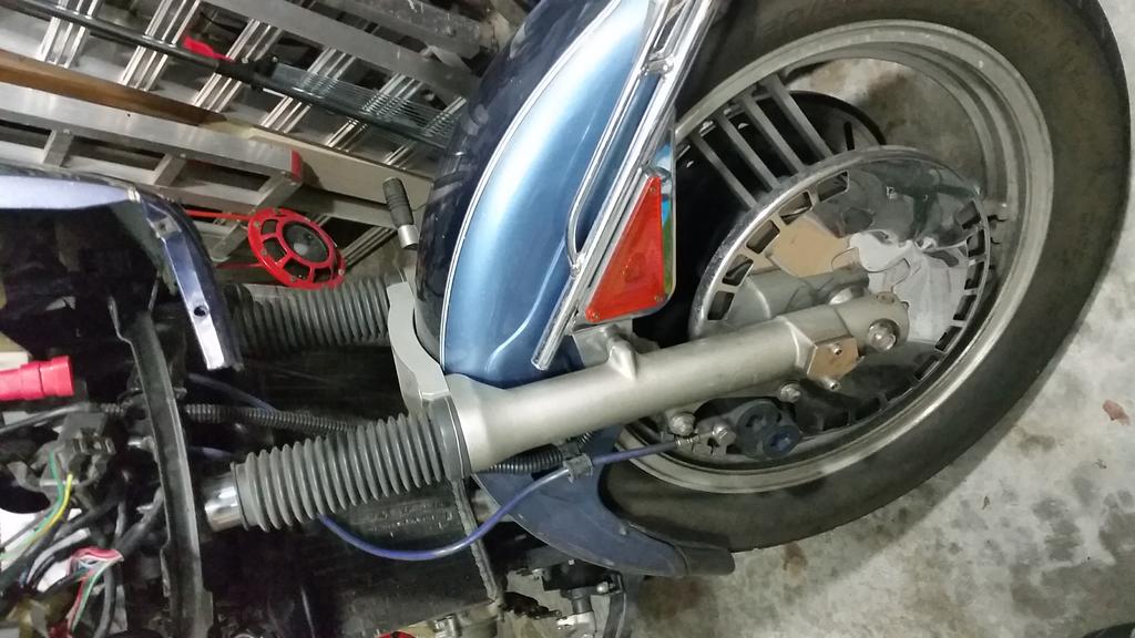

syscrusher Posted August 12, 2016 Posted August 12, 2016 That's a nice looking brace. With the design shape it probably was done on a water jet. The brace I had for the group buy was a CNC and flatter. [ATTACH=CONFIG]106830[/ATTACH] I looked it up, it looks like I bought it in October of 2014. You weren't selling yours at the time and someone posted this one. It looked good to me and so I jumped on it. I did notice that Ebay shows the listing as ended July 1st so the trail's not so cold: Ended: Jul 01, 2016, 7:37AM After my April accident in 2015 I replaced the front forks and installed this brace. I like it. Here's what it looks like on a Gen 1.2, what you see is safety wire wrapped around the bottom of my dust boots. I had to cut away the rubber on the insides of the boots, leaving only a small bead on the bottom. The fork brace was very slightly radiused on the bottom inside and the fork slider itself has a groove in that location all the way around. It was just enough room for me to mash my retention system in place as the brace was installed. It's a tighter fit than it ever could have been without the extra material. Shimmed to the max. Let us hope I don't need to replace fork seals or anything of that sort for many years to come. Chunky Brace
