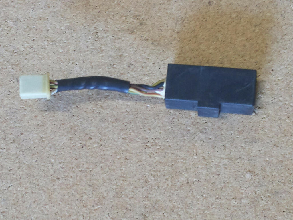

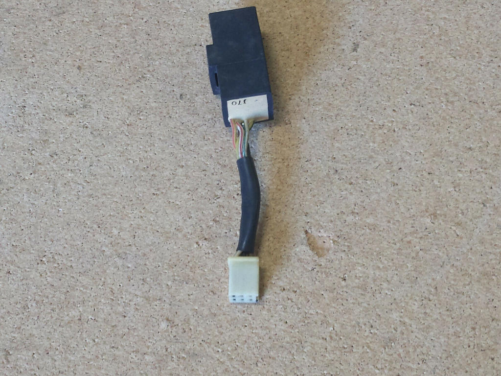

The cancelling unit for the 1983 (26H or 31M VIN prefix) is part number 1A0-83395-03-00. It is a distinct separate unit from the turn signal flasher and from the hazard flasher.
1983 FLASHER-CANCELING UNIT-1A0-83395-03-00.jpg1983 FLASHER-CANCELING-UNIT-1A0-83395-03-00.jpg1983  FLASHER-CANCELING-UNIT-1A0-83395-03-00.jpg

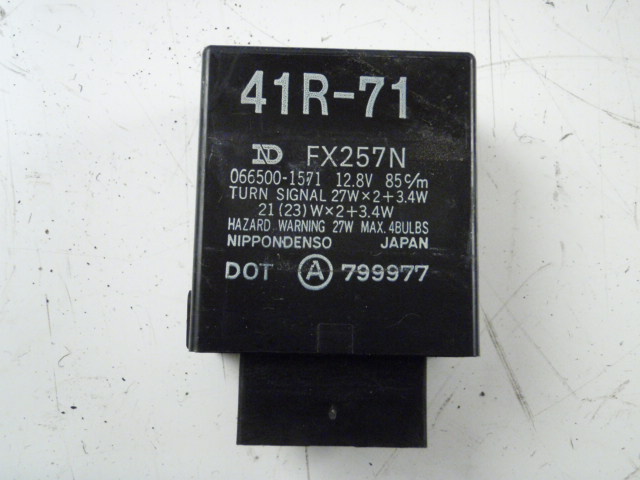

If, on the other hand, you in fact have a 1983½ model (47R or 47T VIN prefix), the canceling unit is integral with the turn signal flasher and the hazard flasher all in one unit. Part number for that combination relay/canceling unit is 41R-85740-00-00.
Provide your Venture's VIN to be sure.
