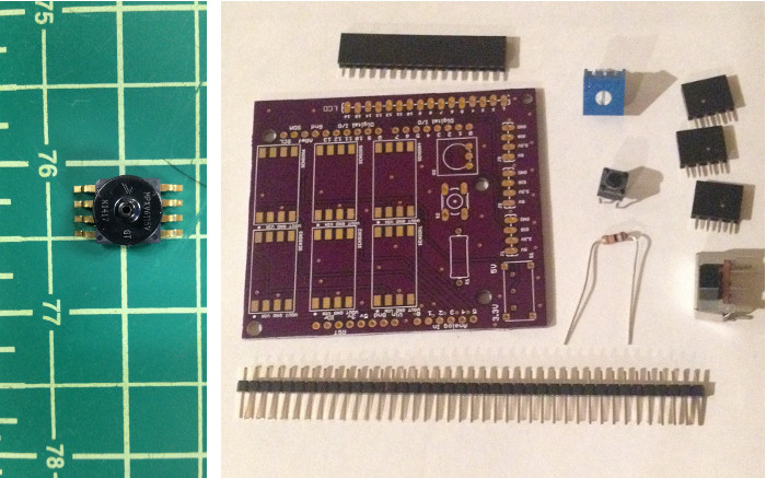

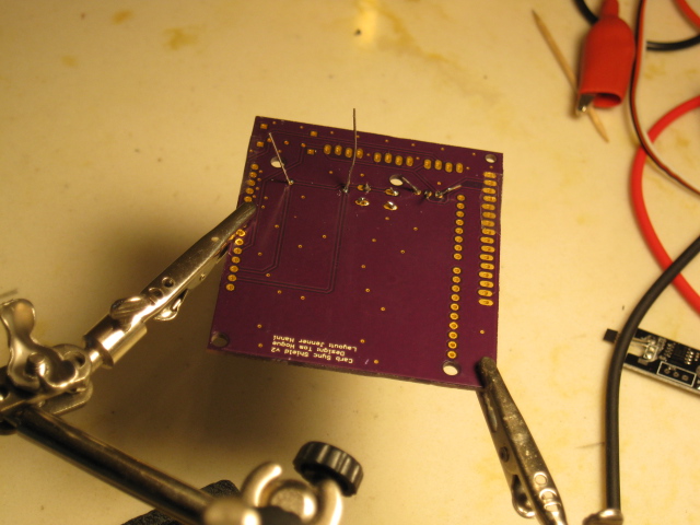

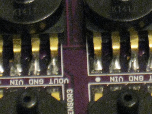

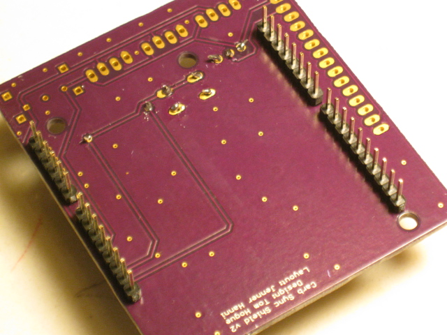

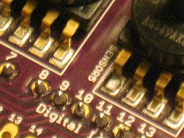

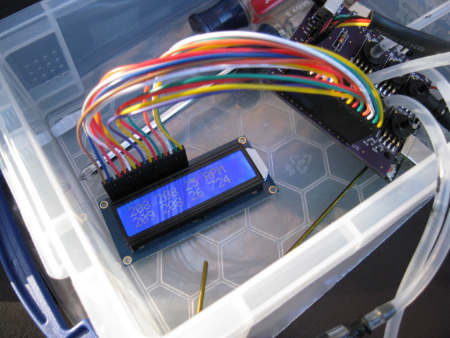

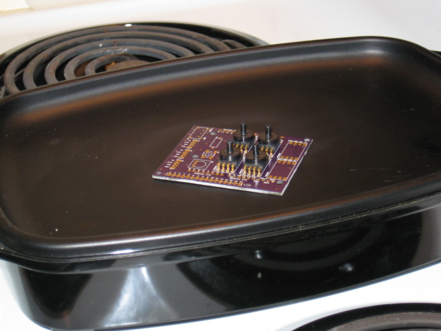

tz89 Posted September 22, 2014 Author #58 Posted September 22, 2014 (edited) I got my proto board. The pictures show one blank and one with parts soldered on. Easy to build. Found some issues (like the surface mounted LCD dimmer pot) so I'm going on to the next version, but I thought I would show and tell. This board allows me to test different configurations - that's why it seems to have so many headers. A board for use would only have what it needs. Edited September 22, 2014 by tz89

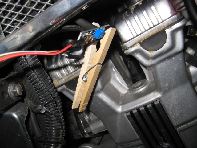

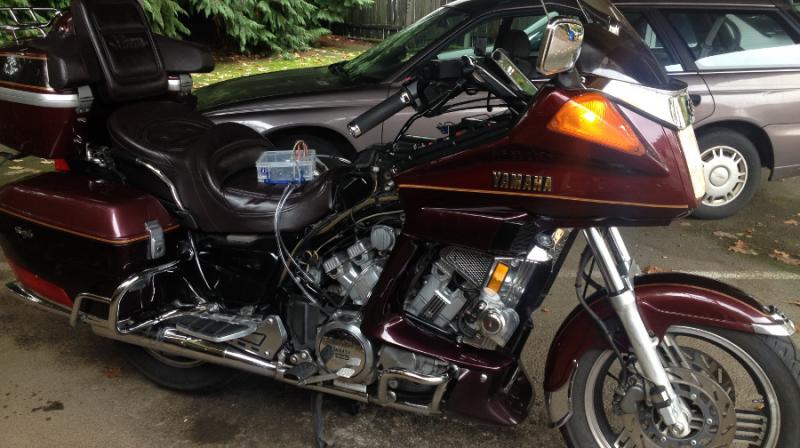

tz89 Posted October 4, 2014 Author #61 Posted October 4, 2014 A successful test of my current board on my bike today. Also, I was able to use a hall sensor to detect spark plug wire pulses - so RPM is doable. My new board design goes to the fabricator this week. Then I'll build one or two, test and post.
