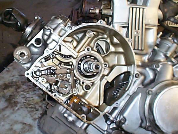

yamihami Posted August 27, 2012 #1 Posted August 27, 2012 (edited) Hi gang allow me to introduce myself, I just bought a new for me 1991 Venture Royale so my wife and I could go touring 2 up. The Venture only has 72,000km so my thought was uhm just broken in. My other steed is a BMW 1989 k100rt with 125,000 km, my wife just doesn't find it comfortable for long hauls so its gonna have to go. Anyhow back to the subject at hand. There is a whiney drone coming from the engine area. The sound occurs while riding, and occurs when I release the throttle and last until the engine revs are very low, it happens all the time at any speed and in all gears. I suspect something to do with the clutch. This evening I removed the presure plate the friction plates and clutch plates, all are within specs. I have not yet removed the basket however I did grasp it in my 2 hands and was able to slightly move it laterally forward backwards and up and down. Here is my question am I right to suspect that the bearing just behind the basket might be worn or damaged as any play in the basket (shaft) doesn't seem right. Maybe worn bearing, side play affected by the torque of the engine compression slowing down the bike? Check out this picture it was taken by Freebird and this is what he found behind his clutch basket notice the bearings, the cage is broken I suspect this could cause the severe noise I am experiencing. http://www.venturerider.org/engineremoval/images/815.jpg Edited August 27, 2012 by yamihami added link

yamihami Posted August 27, 2012 Author #4 Posted August 27, 2012 (edited) Interesting! however my problem is not just a whine, riders beside me have questionably commented about it. My 1st bike was a Seca750 and there was a normal yamaha whine to it. my 2nd bike is a BMW k100rt it also has a particular normal whine to it. But this Venture whine, drowns-out the sound of the engine, again this is only during normal decelerations while under engine compression. My angst concerns the lateral movement of the clutch basket that I am able to generate by simply moving the basket. I would suspect this probably generates the vibration that results in the sound I hear. Anyhow I will remove the clutch boss and basket so as I can have a better look at that bearing before I drop the engine and most likely end up changing that 'bearing'! I have the Yamaha service manual thanks to this web site, but I have been wondering if there are any Clymer or Haynes books for the Venture. I like working with these 2 other books because they take into account that I don't dabble in these areas of expertise all the time and will mention or note important side notes. If anyone does have these books I would be greatfull if they would send me the related chapters on engine removal/installation as well a engine/clutch overall or anything relevant to the matter. Of course being able to own one of these books would be even better. thank-you. Edited August 27, 2012 by yamihami

yamihami Posted August 27, 2012 Author #6 Posted August 27, 2012 (edited) Just to make sure we are talking about the same part its also called the clutch housing. Mine moves in and out slightly and also wobbles side to side. I can only imagine what the gear mounted to this housing has been doing to the driven gear. I hope there was no damage done. The guy I bought it from had it for 4 years with this noise. ouffff. Edited August 27, 2012 by yamihami
Yamamike Posted August 27, 2012 #7 Posted August 27, 2012 That "side to side" movement is what I would be concerned with...sounds like a bad bearing to me IMHO.
Condor Posted August 27, 2012 #8 Posted August 27, 2012 yamihami said: Just to make sure we are talking about the same part its also called the clutch housing. Mine moves in and out slightly and also wobbles side to side. I can only imagine what the gear mounted to this housing has been doing to the driven gear. I hope there was no damage done the guy I bought it from had it for 4 years with this noise. ouffff. Because it takes a special tool (OK some folks have made their own) to properly torque the boss/basket nut. Some will cheat and tighten the best they can and leave it at that. If I remember correctly the nut should be torqued to 50ftlbs. There's also a special washer with keeper tabs that fits over the spline, and the nut that may be loose. I'm thinking the whine may be coming from the straight cut gear being out of alignment a bit??? Anyway I'd suggest taking it apart and reassemble...
yamihami Posted August 27, 2012 Author #9 Posted August 27, 2012 As soon as I get home I will fabricate a special removal tool then remove the boss and the basket and visually check the bearing. I'm psyching myself up though for an engine removal.

yamihami Posted August 27, 2012 Author #13 Posted August 27, 2012 Well I just finished examining everything I jumped the gun to fast the clutch boss is nice and tight on the shaft and there is no play hence good bearing its just the basket that has a slight movement I am able to move it in and out very slightly and there is only a hint of lateral play. I guess this is normal as you say I just wonder how tight the bushing you are mentioning is supposed to be. Now here is something else I removed the short shaft and the bearing to examine them, I then tried to depress the clutch lever only to realize that it is jammed that is to say the long clutch rod going through the center of the clutch shaft is jammed just won't budge. What gives I am stumped???

yamihami Posted August 28, 2012 Author #15 Posted August 28, 2012 You misunderstood me I had not yet reinstalled the disc and plates there was nothing on as I was having this problem. Anyhow I solved the problem (to be truthfull a friend came over and we brain stormed the problem) I removed the slave cylinder and noticed I had probably unseated the seal as it was out to much. The slave cylinder was full of brake fluid and since there was to pressure plate to move the puck back into the cylinder it was probably jammed there and it would not return. Problem solved everything is alright. I do have a question for the experts I measured the thinkness' of the disc all my disc measure .119 in. Should I replace them with new ones. BTW my diaphram spring is well within specs. The problem is my clutch engages only at the last 1/4 inches of lever travel. BTW I had alot of slime and gunk inside the slave cylinder and the brake fluid was very dark. Would this affect grab point.
