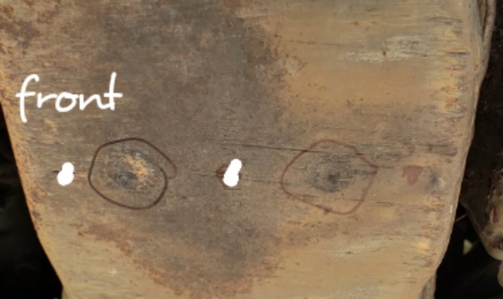

Midicat Posted April 11, 2021 #13 Posted April 11, 2021 @uncledj After reading your post in Gen 1 Tech Library on collector repair I was interested in the idea of a couple of sheet metal screws to hold the baffle in place. So, I thought I would give it a go. I have another collector but thought this might be simpler and also made sense to me. I gently laid the bike on the right side. Marked the tack welds on the bottom with a circle and drilled for screws on the marked dots. Broke 2 bits in the process but got it done. I stood her back up and started her.... Purrs like a cougar now. 😀 No more rattling! WOOHOO! Thank you for your fidgeting that brought this solution to my attention. 👍
