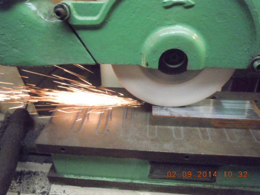

Flyinfool Posted February 9, 2014 Author Share #32 Posted February 9, 2014 (edited) It lives!!! Sparks be a flyin. It took a while to get everything rebuilt (all new bearings) then some electrical issues to iron out. But it is now running. I still need to get some accessories for it, like a diamond dresser to square of the wheel, and some finer wheels (the ones that it came with are very coarse). I still have some cleaning and painting to do on the base casting and a few smaller parts. Edited October 21, 2017 by Flyinfool Link to comment Share on other sites More sharing options...
