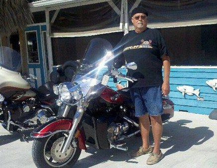

Thanks guys, just an update on the noise, as mysteriously as it surfaced it has gone away. So I guess it is just another of the many noises that makes these bike so unique. Oh well I still get many complements on how good it looks.
Yep those are stock Tour Deluxe pipes with the removable / roatatable tips. I have seen them put on a Venture with stock pipes, but be advised that the Tour Deluxe mufflers have threaded inserts in the cones on the mufflers to accept the screws that hold the tips on. For the Venture mufflers you would need to use some short stout stainless steel sheet metal screws to ensure they stay there and do not rust out.
