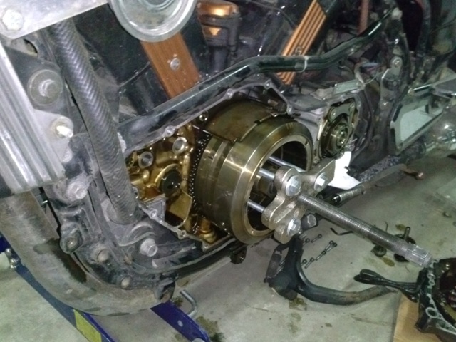

The hot starting, it might be the starter. I tried the voltmeter trick Jeff suggested, and I got 0v on the positive side from the + battery post to the starter post, and I think I got 0v on the negative side from the starter case to the - battery post, but it backfired really loud next to my ear as I was cranking it over so I called it quits.

Well, it's been a while since I added to this thread. Last year I rode it a bunch and didn't really do much more to it. Early this spring, I snagged a parts bike that had a bunch of chrome on it, plus I got a set of floorboards from Orlin. I have been slowly adding the parts on, making my bike a "safety chrome" bike. I also got a 4-brush starter and a new AGM battery, so my starting issues are now gone. I have a few more mechanical issues to touch up, then I can start on the cosmetic issues, like all the cracking & missing tabs, plus get it a decent paint job. Ignore the dirt & duct tape in the pics.

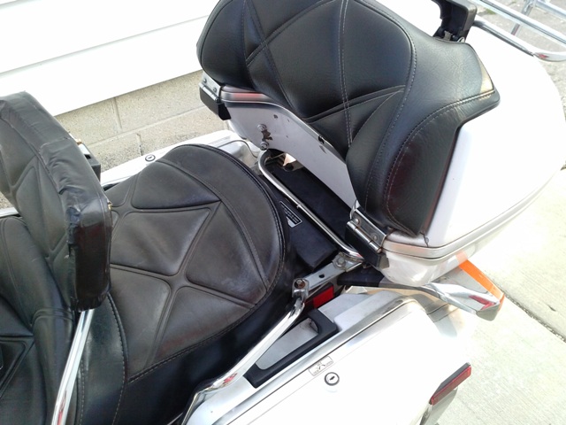

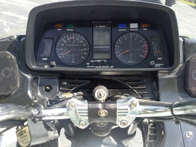

From the parts bike I put the '83 gauges in the '84 gauge pod (like the style of the '83 gauges better, plus it kept my mileage), which allowed me to hook up the gear indicator.

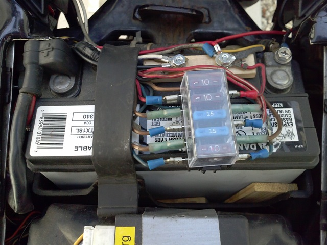

I put in Progressive springs in the front forks, added the Dano starter clutch, and put in a blade fuse holder.

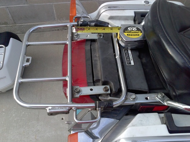

I relocated my trunk back about 3 1/4" with some straps.

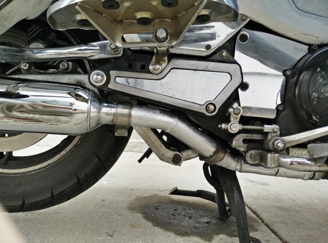

I cut apart my collector to gut it and I also reworked the routing of the exit pipes for a future mod.

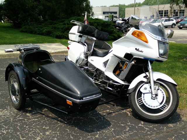

Now for the big addition. Drum roll.....

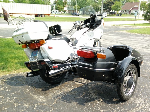

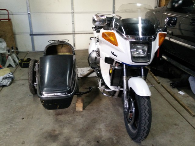

A sidecar!

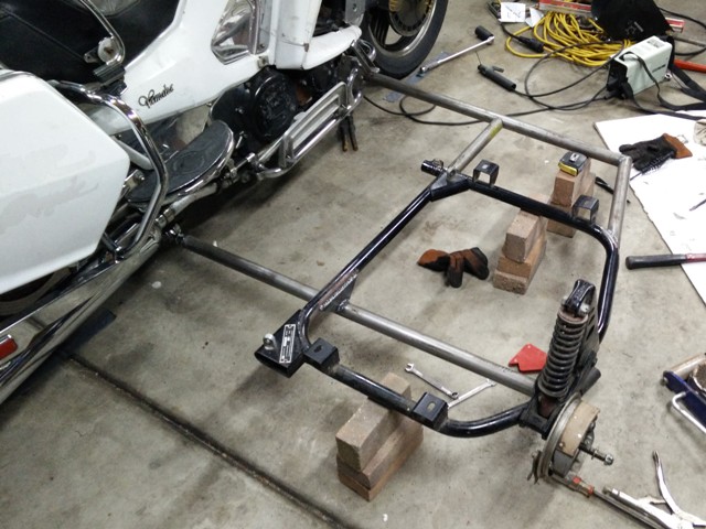

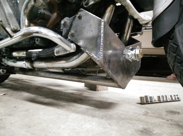

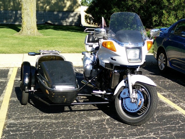

Yeah, this model is intended for smaller bikes, but I'm not adding it like a normal sidecar so it won't see the same stresses. I blame the ADVriders site, they put ideas in my head. I wanted to keep on leaning on my bike, but also wanted to have more passenger space. Enter the leaner. The sidecar mounts to the bike with 2 Heim joints, so you can still lean the bike around corners. Upside is you don't need to make steering head adjustments, it rides more or less like a standard bike, and with the removal of a few bolts and unplug the wiring you're back to a solo bike. Downside is you don't have the training wheel for slippery/gravel/winter roads and you have to put your foot down at stops.

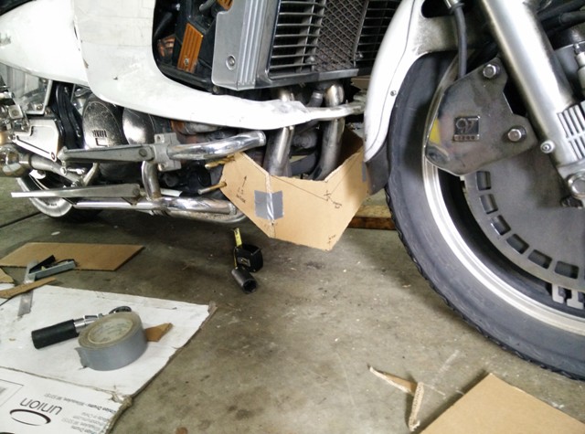

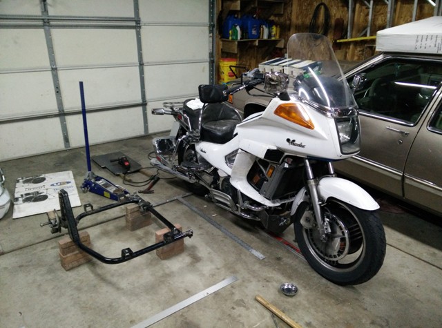

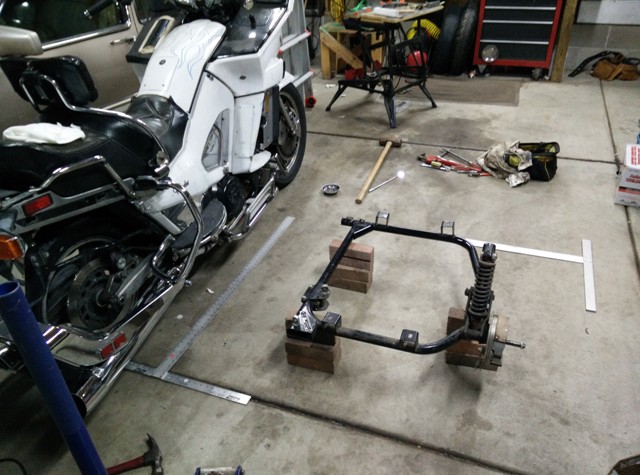

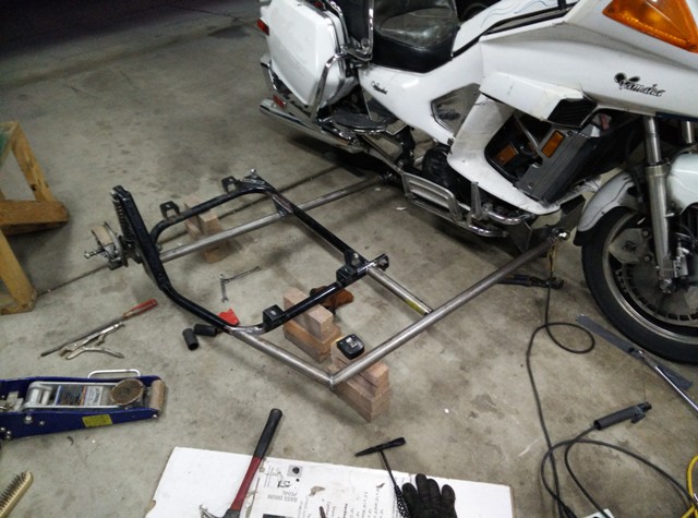

Started off with the layout and built up a subframe for under the bike.

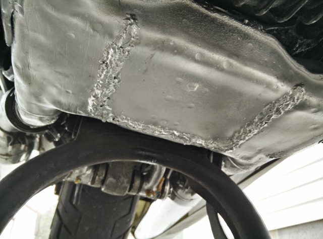

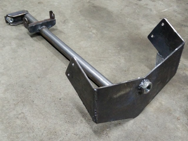

Then started the sidecar frame mods.

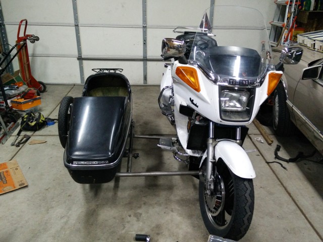

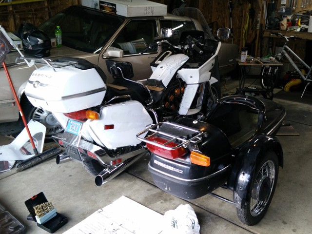

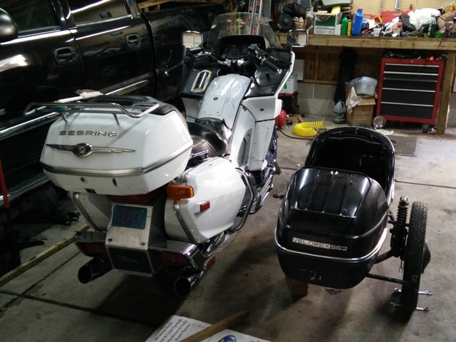

Put it all together.

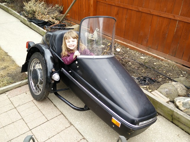

Taking it out.

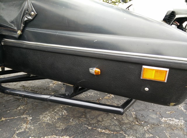

Added a third support so while it's parked it stands straight up. It also allows me to roll it backwards w/o having to balance the bike, and I have used it to go off-road (slowly) and use it for support.

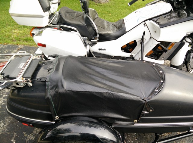

I made a temporary cover (didn't come with one) to keep the rain out. I also want to make a foldable windshield so I can have it down when there isn't a passenger, up when needed. I also need to paint it up and finish adding lights to it.
So far I've taken a few people for rides, and it's been on for almost 1k miles with no issues. I'm really enjoying it.
-Andrew

In 14 I hacked together a rig using a mk2 and a California sidecar that had come off of a goldwing. Yours looks much more put together than mine but with some upper body strength you dont need to do any upgrades to the stearing but they are nice.
I'm glad to see that you've extended the sidecar chassis as to my mind these sidecars are WAY to light for a Venture. I know they are popular in the states, but here they came on the side of 350 Jawas - half the weight and a quarter of the power. With the standard wheel I've bent a stub axle on a Velorex 562 chassis with the extra power of putting one on a GS550. If you are always gentle with it, you may be okay, but if there is anything tougher on offer - or you can weld your own chassis - I'd recommend that option instead.
