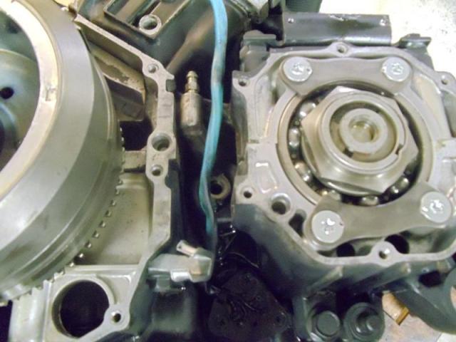

cabreco Posted January 8, 2012 Posted January 8, 2012 I haven't been able to find a write up on here on the r/r of the slave cylinder. I will document my job with pix & post it here for others that follow. Looking at the service manual, I have been able to surmise the following must be done. But I have some preliminary questions I will post in red: 1. Remove bolts on the left footrest-shifter. 2. Remove the 6 allen bolts on the middle-gear cover.. Do I have to drain the oil? 3. Remove the bolt that attaches the clutch line to the slave What size are they? 4 Remove the two allen bolts holding the cylinder to the engine. What size are they? Can I use Allen Wrenchs or will I need to buy metric hex sockets? Also is there a preferred bleeding technique or is it a pain like bleeding my Honda's front caliper? (not enough pressure) Basically That is all the questions I have to prepare for this. I looks simple enough. Andy

Yammer Dan Posted January 8, 2012 Posted January 8, 2012 It is tricky to get out of that hole once it is unbolted. You just have to keep playing with it.
Venturous Randy Posted January 8, 2012 Posted January 8, 2012 It is tricky to get out of that hole once it is unbolted. You just have to keep playing with it. This is true. But sometimes it comes out so easy that it will almost fall out. There is a bit of a trick in the sequence of how it comes out easy, but I don't remember it. Also, the bolts may be real tight to break loose, so make sure you have a good Allen head tool. RandyA
Keemez Posted January 8, 2012 Posted January 8, 2012 Seems to me like those 2 bolts holding the slave cyl in were 5mm? I'm not positive though. Might have been 6s.... could have been 4s for that matter. Pretty sure they're 5s though.
bongobobny Posted January 8, 2012 Posted January 8, 2012 There is one screw on the side cover that is "Special" as it does go all the way thru and some oil will seep out. It is the one on the bottom and there is a copper washer on it. Make that the last screw you take out and just reinstall it into the threads once the cover is off. It does not need to go in all the way, just enough to stop the seeping. Yes, there is a trick to getting the slave out but once you twist and turn it long enough it will literally fall out! I think the first time I did one it took a good half hour to figure out the right combination, and I pretty much exhausted my list of "Special" words! There was a thread about this several years ago, and another one about how buying the whole new assembly was not much more expensive than rebuilding the old one. You might want to check into this. While it's apart you may want to consider installing SS lines as well as it definately stiffens up the feel of the clutch...
Condor Posted January 8, 2012 Posted January 8, 2012 The problem with the slave removal is the tab for the lower hex screw sits on the back side of the shift arm and does not let the slave come straight out. A lot of members get it to come out by playing around with it and when it finally falls out haven't got a clue as to how they did it... Here's the 'trick'. Once the slave is loose drop the bleeder arm down and rotate the slave while moving it out. This allows the top tab to rotate over the shift arm. When installing it, put it in upside down and rotate the other direction. This will get the bottom tab over the shift arm. I hope this makes sense to folks??
bongobobny Posted January 8, 2012 Posted January 8, 2012 I remember you also have to temporarily relocate the wiring that gets in the way...
cabreco Posted January 8, 2012 Author Posted January 8, 2012 I remember you also have to temporarily relocate the wiring that gets in the way... As in move out of the way or disconnect & remove?
Yammer Dan Posted January 8, 2012 Posted January 8, 2012 I remember you also have to temporarily relocate the wiring that gets in the way... And be very carefull not to pinch that wiring when you put it back togather. Don't remember exactly but goes to neutral light?? Or maybe gear indicator.

BradT Posted January 9, 2012 Posted January 9, 2012 Seems to me like those 2 bolts holding the slave cyl in were 5mm? . Yup I think there 5 mm. My short socket allen key, did not fit properly, so used the T handle ones. They are very tight, I assume from the heat. But sometimes it comes out so easy that it will almost fall out. There is a bit of a trick in the sequence of how it comes out easy, but I don't remember it. . RandyA Don't remember because it just falls out and just goes back in, can take a while and get very frustrating. Have fun and good luck. There was a few posts on this but they go a long way back. Maybe before the crash Brad

cabreco Posted January 9, 2012 Author Posted January 9, 2012 (edited) There is one screw on the side cover that is "Special" as it does go all the way thru and some oil will seep out. It is the one on the bottom and there is a copper washer on it. Make that the last screw you take out and just reinstall it into the threads once the cover is off. It does not need to go in all the way, just enough to stop the seeping. ... I didn't notice when I removed this allen bolt, does the copper washer go over or under the mid engine cover? The reason I ask is, I now have a small oil leak which wasn't there before. Looking at the cover I see the washer marks on the outside of the mid engine cover. So I put the washer between the bolt & the cover. That being said, I thing the leak is probably that I need to replace the mid engine cover gasket (it kind of ripped). ANYWAY... The Slave cylinder was not as bad as I expected. No cursing at all (& I'm from NYC). It took me a total of 90 minutes including cleanup & rebuilding the original slave. I did get a used one to put in but decided since I had a rebuild kit to try my hand at rebuilding the original as well. No more leaking brake fluid! Bleeding was not really bad. I basically filled the reservoir and opened the bleeder & let gravity do it's thing. Once only fluid was coming out of the bleeder I closed it pumped the clutch handle & cracked the bleeder to let out air. Did that a few times & bleeding done! Didn't have to use the vacuum bleeder. Clutch nice & tight! As far as being a supporting member of this site, I can definitely attest that it's the BEST $12 I am spending! I've just sent my subscription to Don via PayPal! Thank you all AGAIN for your help. Edited January 9, 2012 by cabreco
dingy Posted January 9, 2012 Posted January 9, 2012 Copper washer goes on bottom hole between screw head & middle drive cover. Gary
cabreco Posted January 9, 2012 Author Posted January 9, 2012 Copper washer goes on bottom hole between screw head & middle drive cover. Gary That's what I thought, did it right. Guess I need a new mid engine cover gasket to stop the drip.
