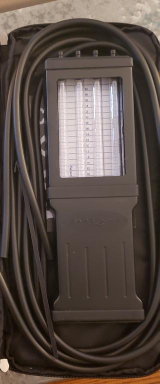

Midicat Posted September 3, 2019 Posted September 3, 2019 I just ordered the Carbtune Pro from the U.K. Total was approximately $130.00 Canadian delivered. Once I get it I will be following the step by step instructions from the Tech Library to try it myself. Fingers crossed. Thomas
saddlebum Posted September 5, 2019 Posted September 5, 2019 (edited) I just ordered the Carbtune Pro from the U.K. Total was approximately $130.00 Canadian delivered. Once I get it I will be following the step by step instructions from the Tech Library to try it myself. Fingers crossed. Thomas In case you need some help you know Carl and/or I are always willing to lend a hand. but you should have no issues. It actually sounds a lot more complicated then it is. The main thing is that they all read the same. I personally like to strive for the highest possible overall vacuum reading I can get at idle RPM and still remain equal on all four gauges. I then crack the throttle a few times to see if the remain relatively equal. If they are too far apart you can always tweak the adjustment a tad to get them to rise equally but normally if they are good at Idle they should pretty much remain so through out the throttle range providing the carbs are in good operating condition. Edited September 5, 2019 by saddlebum

Midicat Posted September 16, 2019 Posted September 16, 2019 (edited) Oh Happy Day! Look what just arrived! Now I have to learn how to use it. I want her to run smoother rather than not run at all. Thomas Edited September 16, 2019 by Midicat
