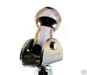

Condor Posted August 26, 2011 #6 Posted August 26, 2011 Check with Condor. He has the swivel ball on his hitch, Actually I picked up one of those 'tilting' balls off Ebay. I was sceptical, but after pulling the trailer to Cody and back I'm a believer. Didn't even know the trailer was there... The nice thing about the ball is any MC trailer will work with it. With the swivel coupler it's only on one trailer.

SilvrT Posted August 26, 2011 #8 Posted August 26, 2011 Actually I picked up one of those 'tilting' balls off Ebay. I was sceptical, but after pulling the trailer to Cody and back I'm a believer. Didn't even know the trailer was there... The nice thing about the ball is any MC trailer will work with it. With the swivel coupler it's only on one trailer. What bothers me about either the swivel hitch or this swivel ball is, what stops either of the components from riding on their edge so to speak. Example, in the case of the swivel ball, what's keeping the ball straight up? ... seems to me that once weight is applied, it will tilt to one side or the other, causing the hitch to be at an angle to the ball .... knowutimean?

Condor Posted September 5, 2011 #18 Posted September 5, 2011 I have 2 trailers, 1 with, 1 without a swivel. I can't tell the difference while pulling them. NOW, if you go down, the trailer with a swivel will stay with the bike, is that good ? I don't know, if you hit a curb or deep pot hole or large road debris it could flip over on you. I put one of those tilting balls on mine. It pulls great, and it won't go all the way over like a swivel hitch.... which might be a good thing.... I cut a corner a little too much coming out of a reststop last month and hit the curb. She bounced pretty high but settled right back down... Might have flipped if it had been a hitch...
