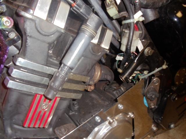

dingy Posted August 18, 2011 Posted August 18, 2011 The 1st gens have a port on each exhaust header. The front ones are about 6-8" ahead of collector on lower outboard side. The rears are just past the clamp that connects down pipe to extension from rear head. #10 mm metric head. Be gentle they can be twisted off, but then no harm no foul, threaded portion still keeps hole closed. Gary

dingy Posted August 19, 2011 Posted August 19, 2011 Here is a picture of rear one, can't find a picture that shows the front one, probably more like 3" ahead of collector. Gary

dingy Posted August 20, 2011 Posted August 20, 2011 Few pictures of the gas sniffer ports on the 1st gens attached. ID of the hole with the screw removed is a tad over .190" Gary
