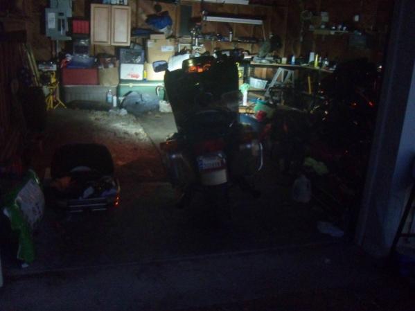

Rick Haywood Posted August 26, 2011 #7 Posted August 26, 2011 Here is a couple of pictures of how I lit mine up in the back LED strips down the frame between the bags and fender. LED strips under the truck and 6 other lights that are round led bulbs and 2 of them are brake lights also.
