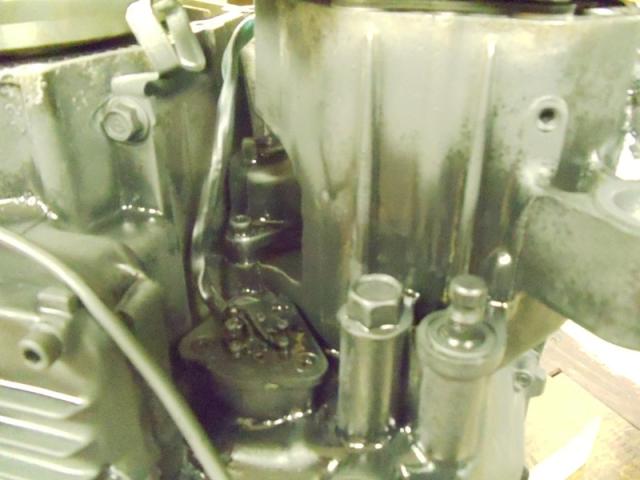

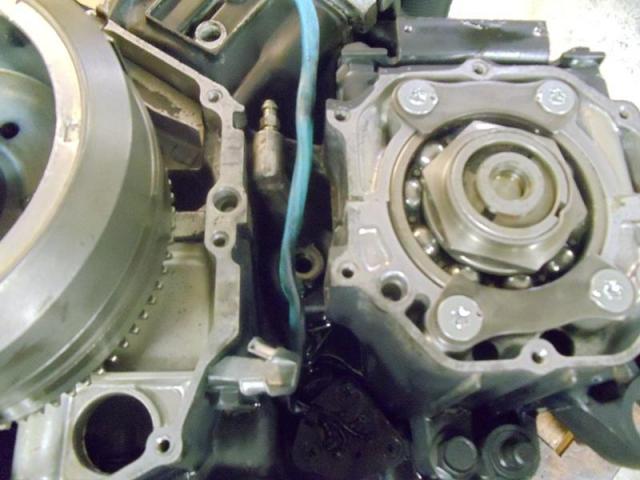

dingy Posted March 28, 2011 #2 Posted March 28, 2011 Here are a few pictures of a 1st gen shift indicator segment. From the parts fiche, it looks like the RSV is very similar, you may not use all the contacts though .The segment is sealed by an an o-ring. Probably can be reused, but might as well get it, about $1. On the 1st gen, the middle drive cover has to come off to get to it, so you will need that gasket. Once removed, the switch can be cleaned with a scotch brite pad or something similar. What may have worn out is the pin on the end of the shift segment, shown in last picture. This can be replaced once the switch is removed. Also get the spring behind it. You have to remove 3 phillips head screws to get switch out. Switch is $25.42 from partshark.com Gary
