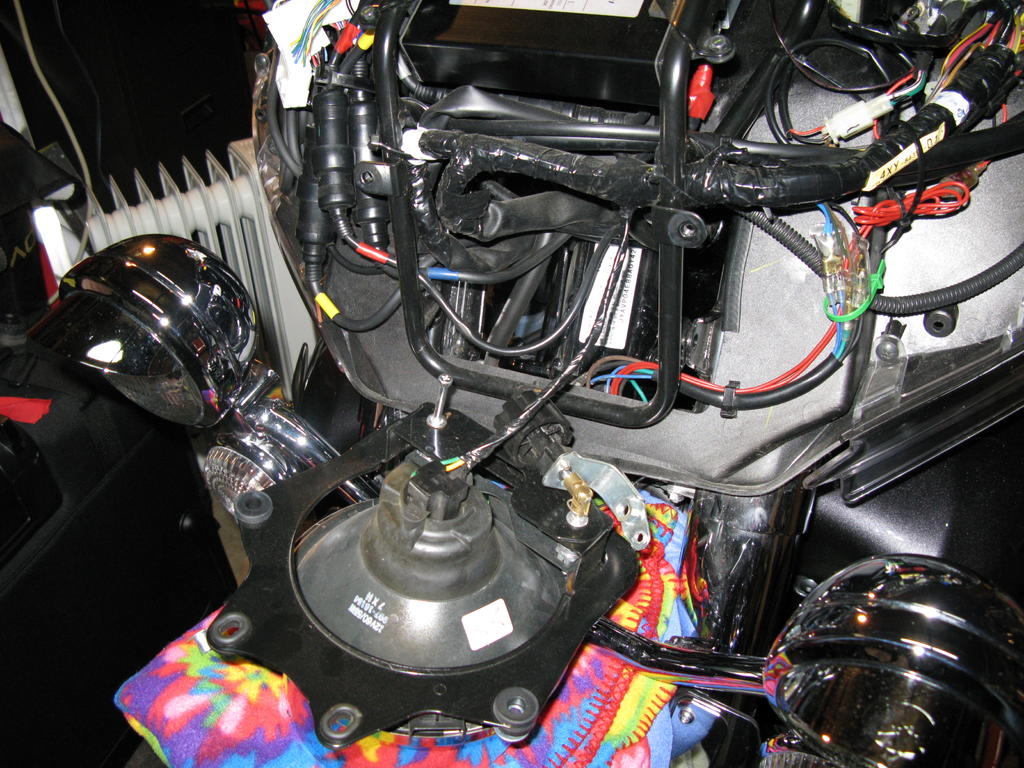

snyper316 Posted November 22, 2016 #37 Posted November 22, 2016 The back up fuse provides keep alive power for the audio system. Unplug the cable to the cd changer if you have one and see if the drain goes away. The cd changer is always alive and sometimes the cartridge will get askew causing the changer to pull excessive power. if it is not the cd changer the plugs for the others are under the fairing. And there is a power plug at the cb under the trunk. Mike Ok Now I feel like a troll, But I do not have cd changer but now that you mention it because I have an aftermarket Sony AM/FM/Mp3/CD/ with front Aux and after 2-3 days I have to charge the Battery. It will crank but not enough voltage to make it spark.
MikeWa Posted November 22, 2016 #38 Posted November 22, 2016 I opened the fairing..And I don't see anything wrong ...........I don't even know what to look for On the upper left of this picture you will see some large black round connectors. Unplug them one by one. Plug each in and out several times. Before the final reconnect put some dielectric grease on the pins. Be sure only to use dielectric grease which is available at auto parts stores. Good Luck Mike
