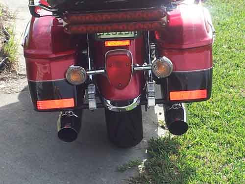

Atoolnut Posted February 6, 2013 Posted February 6, 2013 How did you wire them with a relay..I thought they would just go in line with existing connectors?
Cougar Posted February 6, 2013 Posted February 6, 2013 In my case if I just wanted them to glow just light, I would have just wired them direct pretty simple like you say. I also wanted to make the lit side reflectors to blink as well, it's pretty cool when there running. make's it so the cagers can see my blinkers on the side and what I want to do as far as turning. make since? in other words there is nothing that cars see when there to your left or right . this helps :-) had to use the relays to have them both blink and be running lights at the same time. it took one relay for each side. Jeff
djh3 Posted February 7, 2013 Posted February 7, 2013 If you go to the thread I have linked in a post above there is an explanation on how to build a circuit to make LED light with the running lights and still work as blinkers also. Also in that thread if your not inclined to tackle the soldering task a fellow offered up to sell some he had pre-made. Check out the lights from these folks. Made in USA for me thats a +. Good quality stuff. Mounts available in black or chrome and in single pin (self ground) and double pin 2 wire. If you call you will actually get to talk to a human that speaks regular english.

Atoolnut Posted February 7, 2013 Posted February 7, 2013 Cougar can you post or pm wiring for relays for flash/ run reflectors....cant get my head around wiring this...is it a different relay type? than a normal 4 post....I dont want to reduce output of led in running mode....custom dynamics has harness $24 that keeps full power to both sides.thanks
Cougar Posted February 7, 2013 Posted February 7, 2013 Les, my drawing is someplace out in the garage at home... For 24 bucks and it does the same thing as mine I would go with that. the relays I use are the 87/with 87A on them. post the link on what your looking at here please. Jeff
Atoolnut Posted February 7, 2013 Posted February 7, 2013 http://www.customdynamics.com/eclipze_module.htm this is harness......with a relay wouldnt constant flasher use wear out the relay.....would still like to see wiring diagram
Cougar Posted February 8, 2013 Posted February 8, 2013 Sure, remind me over the weekend and I will see if I can find it and then shoot a photo for you. been a while since I did this. and to remember it all with out the paper old age I guess I think I have 5 or 6 relays under the hood now constant flasher use wear out the relay maybe over time What about your car blinkers? I get my relays for like $2.99 an amazon. Jeff
Flyinfool Posted February 8, 2013 Posted February 8, 2013 The only issue wit the harness from CD is that it has a max power of 300mA. Now you got my gears grinding in my head again...........
Flyinfool Posted February 8, 2013 Posted February 8, 2013 I'm thinking of a simple solid state circuit with 3 resistors and 2 NPN Transistors. A solid state circuit will not wear out contacts like a relay will. Although a quality relay may still outlive the bike. It would be a more simple hookup with a relay to.
Atoolnut Posted February 8, 2013 Posted February 8, 2013 300ma...thats limit?...how many ma in these reflectors...they have 15 led ....how to tell what ma is?.....since these led will be wired at point where turn signals connect then down to led would there be a large draw...how do you measure ma draw on a light or led?..also how do you measure RSV amp output.....have 5 relays on already as been paying attention to posts re wiring
Flyinfool Posted February 8, 2013 Posted February 8, 2013 300ma...thats limit?...how many ma in these reflectors...they have 15 led ....how to tell what ma is?.....since these led will be wired at point where turn signals connect then down to led would there be a large draw...how do you measure ma draw on a light or led?..also how do you measure RSV amp output.....have 5 relays on already as been paying attention to posts re wiring Exactly which lights do you have. You say they have 15 LEDs? A rough rule of thumb is 20mA per LED, BUT this is not always the case. You can either measure the current draw with a multi meter, or some manufacturers actually will tell you the current draw.

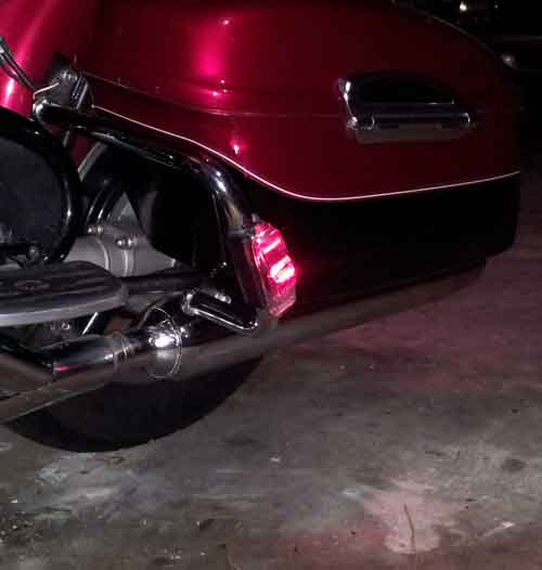

djh3 Posted February 9, 2013 Posted February 9, 2013 Finished up my reflector/LED swap today. Mounted up the fronts.
Atoolnut Posted February 10, 2013 Posted February 10, 2013 Decided to wire up led reflectors today ...since there's 15" of snow here......wired positive to + of running light and- to positive of turn signal......running lights are as bright as if they were wired normally but when turn signal activated..reflector flashes opposite of turn signal..as in wig wag style......any thoughts about will this decrease life of bulbs in turn signals?wiring issues?
