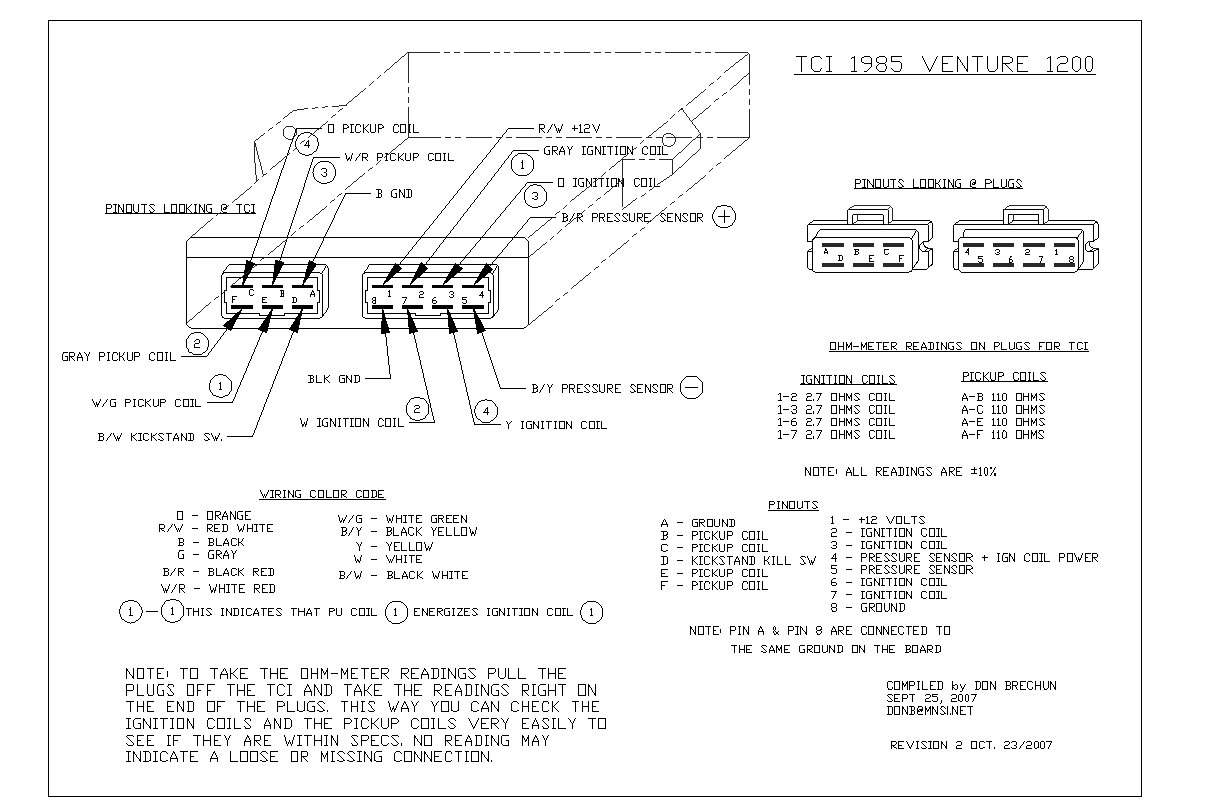

Dano Posted August 21, 2010 #4 Posted August 21, 2010 Since you'll have the neccesary stuff out of the way, pull the TCI out, re-route the wires up around the starter solenoid and put that thing on top of the air box. Much easier to diagnose and swap out if needed. Now if I could just find the link to the TCI diagnoses sheet that someone came up with so you could print it out and use it......... Someone? Anyone????
dingy Posted August 21, 2010 #5 Posted August 21, 2010 Dano, Is this one you are referring to? aedlee, Check ignition fuse in fuse block, second one down. Check that it is secure in fuse block, these tabs weaken and do not provide good contact. If bike is cranking, the only switches involved would be the tip switch in headlight bucket or the side stand switch. Try starting with bike in neutral & side stand up. If it starts, probably side stand switch. Check pickup coil connector. Located near rear shock air damper adjustment, behind side cover. Gary
Dano Posted August 21, 2010 #6 Posted August 21, 2010 Yup Gary, that's it. Finally dug it out of my VR book and found the link at the bottom of the printed page. http://www.venturerider.org/images/tci.jpg

mbrood Posted August 23, 2010 #12 Posted August 23, 2010 Check to see if pin "D" is grounded.. if it is... one of the safety switches is killing the ignition. You can actually back the pin out of the white housing and the ignition WILL be turned back ON... but it won't care if the side stand is up or down or if the kill switch is thrown or not.http://www.bergall.org/temp/venture/tci/tciplugs.jpg

mbrood Posted August 23, 2010 #15 Posted August 23, 2010 With the ignition ON, you should read +12 volts at each of the coil outputs on the TCI. With the ignition OFF, you should see a resistance reading of about 23k Ohm from the ignition fuse to each of the inside of the spark plug caps (10 for the reistor in the cap and 13 for the ignition coil secondary winding).
