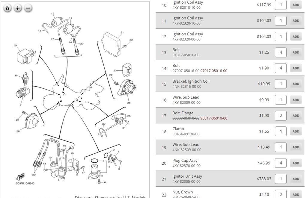

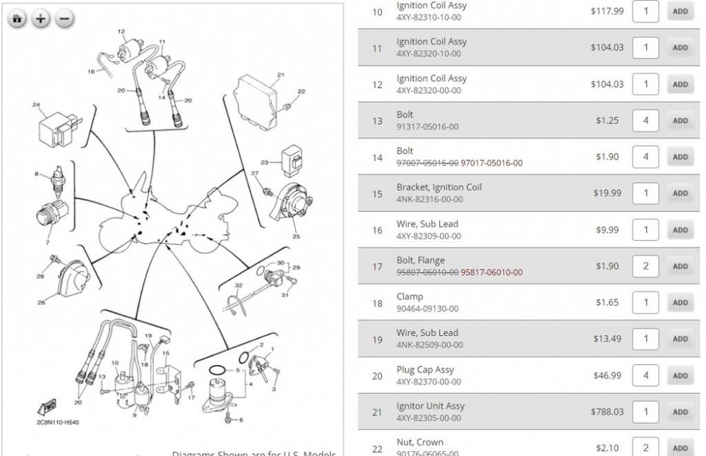

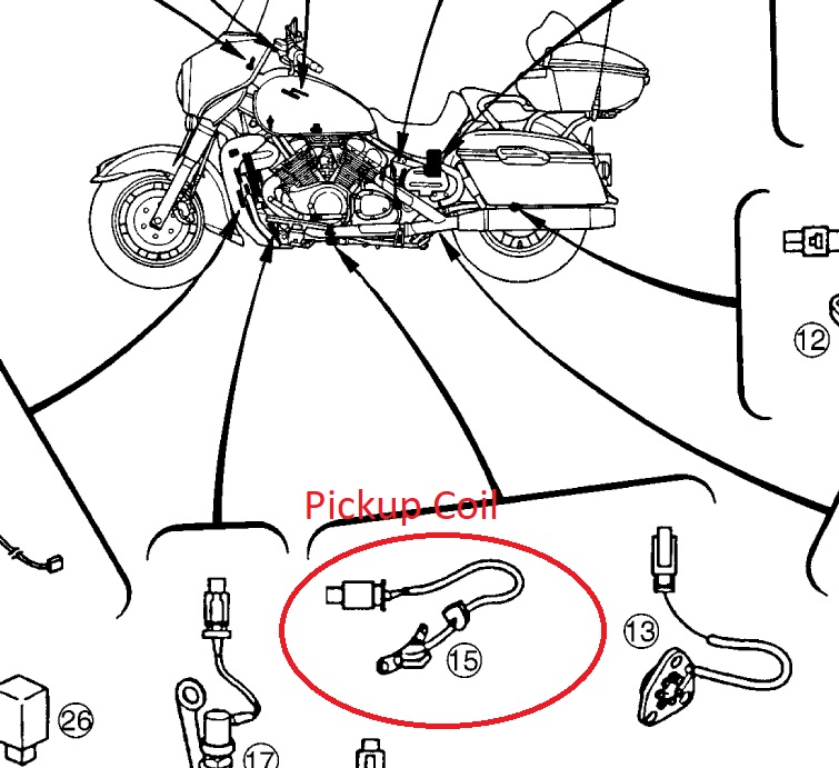

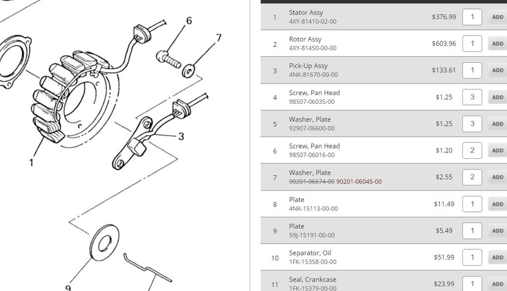

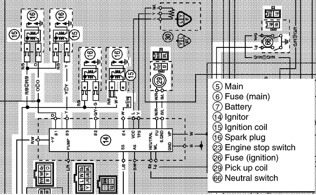

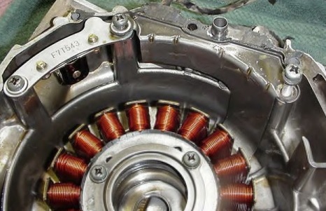

Du-Rron Posted June 21, 2019 #26 Posted June 21, 2019 Cowboy said: Du-Rron, I checked the main fuse box Left side behind the drivers leg under the cover I checked the Second Fuse Box and the black box with two plugs that is on the right side behind the front lower All plugs and boxes free of dust and dry as a bone sitting in the sun. Plugs had the dielectric gel on the outside edges of plug. Seemed to work like it is meant to keep out water or moisture. Male & Female sides looked clean and free of any type of corrosion. I did not check the plug for the Rectifier but I will look at it. How and where are the plugs for the Coils. I have seen the Coils but never really followed the wires to see where they plug connections are. Do you know where the pick up coil plug is located. I would like to find and check it for water and corrosion. Stator wires are soldered with no plug as I did not trust the plug. Thank You for the response and wish me luck. Brian Shoemaker If you yourself replaced the stator then you were also looking at the pickup coil. The spade connectors for the coils run back to the ignitor box. here is some pics to help you on the road.

Cowboy Posted July 21, 2019 #34 Posted July 21, 2019 Great news finally got the bike washed and broke down to access the plug for the Pick-up Coil. It is bad as I expected and as Scott has had first hand experence with. I got the new pick up coil and gaskets and oil and new spark plugs put in. I let the fuel pump pressurize and hit the start button, It fired right up without hesitation. I would like to let everyone know that I appreciate all the discussion and thoughts about the possible issue. I would also like to stress to anyone whom might be having starting issues to look at this post. I have a 2004 Midnight Royal Star Venture with 140,000 mile on it. It has always been garage kept and serviced by my self. I have never seen a issue like mine where the bike had a hard time starting in the morning. But after starting in the morning it never had an issue for the remainder of the day. I know that the bikes are solid and very seldom have an issue, especially if you ride them on some sort of regular basics. So lets talk about the issue. Slow or Hard Start. Some say fuel pump Some say fuel filter Some say Carbs Some say Battery Some say ECU Some say Spark Plug Wires Some say Coil Packs Some say Pick-Up Coil that is next to the Stator All good points but in my case if you pull the spark plug wire and put a spare plug on it and you have no spark. I would test the Pick-up Coil. It is located in the area of the fuel pump & fuel filter. The metal clip that is attached to the bolt on the engine side of the drive shaft. It is easy to access if you remove the cowls on each side of engine. Remove the interior plastic painted cover. Remove the fuel pump. Remove the fuel filter. Remove the radiator reservoir. There are several wires in the metal clip. One is the 3 wire from the stator. One is the two wire from the pick up coil White Plug. One is the two wire coil Black Plug. Pull the 2 wire plug apart and test the Pick Up Coil. I would bet that the pick up coil is bad and not sending signal to the ECU. Therefore the bike is not getting fire to the spark plugs. All is well the bike is running like it was new. Thanks again to all.
