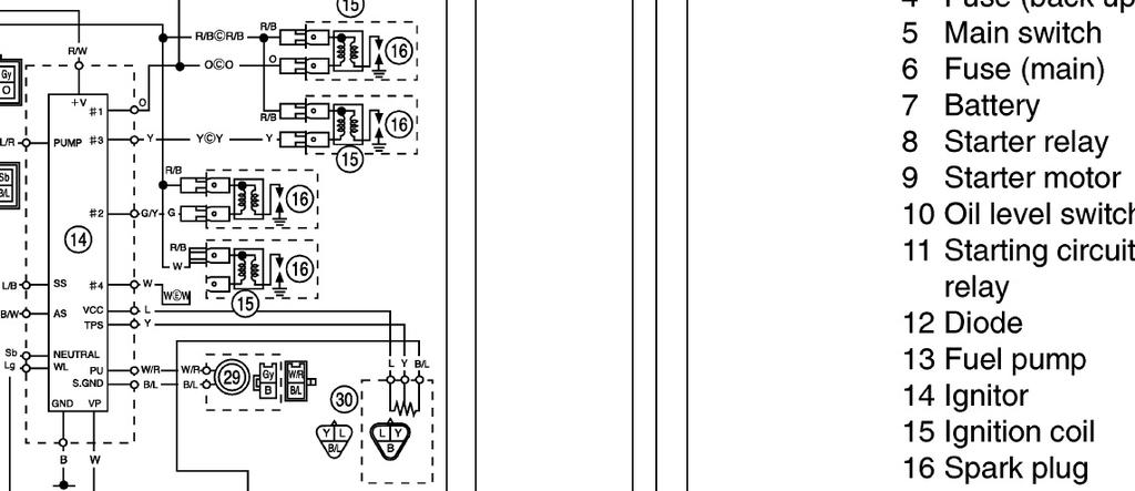

Cowboy Posted June 21, 2019 #20 Posted June 21, 2019 Need help as I am on a long trip and the bike is not wanting to get spark first thing in the morning! History Before leaving May 28th New Air Filters New Fuel Filter New Spark Plugs Can of Seafoam Second day out had to ride in some of the heaviest rain I think I have ever rode in, Lasted 2 1/2 hours. Bike never missed a beat. Next morning seemed a little slow to crank but nothing of concern. Fourth day rode thru water on the road between 6 and 10 inches deep. Never missed a beat for the remainder of the day. Next morning seemed a little slower to start. Fifth day I changed the fuel pump thinking I might not be getting proper fuel pressure, since I had never changed it with 140,000 miles on it. Battery Load Tested 12.3 Volts fully charged and no bad cells. Voltage meter shows charging at 13.2 at idle and 13.7-13.9 while running down the road. Drained the carb. bowls to make sure no water in fuel. Stopped in Hamilton, MT Yamaha shop to discuss with mechanic. Since it only happened in the mornings he could not check anything but he gave me a spark plug and told me to check for spark first thing in the morning. I did the next morning and found that the two rear plugs wires were not getting any spark. Did not check the front due to easy of getting to. After finding no spark he told me it was probably the Stator even though it was charging, it also was part of the ignition signals. SO I replaced the Stator in Sandpoint, ID. Problem not solved. I have been getting someone to let put my jumper cables on their truck and I have to let the bike's starter turn over for 15 seconds or more several times and then all of sudden it starts. I spent the last week in BC & AB along the Icefields Parkway. Finally back in the states and left Glacier National Park this morning. I took the bike 12 different times of grinding on the starter before it finally fired. Starting to get worried that it is going to just not start and / or damage the starter. Wish the Yamaha dealer would have told me to change the Pickup Coil / Pick-Up Assy while I was changing the Stator!! How do you try and test or diagnose while on the road away from home. Once the bike cranks in the morning I have not had a problem starting for the rest of the day even if we go for a hike or long lunch. Starting too really worry that I will get stuck out in the middle of no where.
Du-Rron Posted June 21, 2019 #21 Posted June 21, 2019 Cowboy said: Second day out had to ride in some of the heaviest rain ... Fourth day rode thru water on the road between 6 and 10 inches deep... The 10" of water along with a good rain soaking makes me suspect wiring that needs to be checked. Unplug from the rear coils all the way back and clean/dry/wd-40/then dry the wiring. Check battery wiring and grounds. Check the starter solenoid/main fuse and make sure they are clean and dry.
Patch Posted June 21, 2019 #22 Posted June 21, 2019 Cowboy said: Need help as I am on a long trip and the bike is not wanting to get spark first thing in the morning! History Before leaving May 28th New Air Filters New Fuel Filter New Spark Plugs Can of Seafoam Second day out had to ride in some of the heaviest rain I think I have ever rode in, Lasted 2 1/2 hours. Bike never missed a beat. Next morning seemed a little slow to crank but nothing of concern. Fourth day rode thru water on the road between 6 and 10 inches deep. Never missed a beat for the remainder of the day. Next morning seemed a little slower to start. Fifth day I changed the fuel pump thinking I might not be getting proper fuel pressure, since I had never changed it with 140,000 miles on it. Battery Load Tested 12.3 Volts fully charged and no bad cells. Voltage meter shows charging at 13.2 at idle and 13.7-13.9 while running down the road. Drained the carb. bowls to make sure no water in fuel. Stopped in Hamilton, MT Yamaha shop to discuss with mechanic. Since it only happened in the mornings he could not check anything but he gave me a spark plug and told me to check for spark first thing in the morning. I did the next morning and found that the two rear plugs wires were not getting any spark. Did not check the front due to easy of getting to. After finding no spark he told me it was probably the Stator even though it was charging, it also was part of the ignition signals. SO I replaced the Stator in Sandpoint, ID. Problem not solved. I have been getting someone to let put my jumper cables on their truck and I have to let the bike's starter turn over for 15 seconds or more several times and then all of sudden it starts. I spent the last week in BC & AB along the Icefields Parkway. Finally back in the states and left Glacier National Park this morning. I took the bike 12 different times of grinding on the starter before it finally fired. Starting to get worried that it is going to just not start and / or damage the starter. Wish the Yamaha dealer would have told me to change the Pickup Coil / Pick-Up Assy while I was changing the Stator!! How do you try and test or diagnose while on the road away from home. Once the bike cranks in the morning I have not had a problem starting for the rest of the day even if we go for a hike or long lunch. Starting too really worry that I will get stuck out in the middle of no where. ridiculous about the stator! I'll post later, but likely others will chime in soon. Patch & I'll pm you my number in case you need walking thru.. Still in Canada?
Cowboy Posted June 21, 2019 #23 Posted June 21, 2019 Du-Rron said: The 10" of water along with a good rain soaking makes me suspect wiring that needs to be checked. Unplug from the rear coils all the way back and clean/dry/wd-40/then dry the wiring. Check battery wiring and grounds. Check the starter solenoid/main fuse and make sure they are clean and dry. https://www.venturerider.org/forum/attachment.php?attachmentid=116812 Du-Rron, I checked the main fuse box Left side behind the drivers leg under the cover I checked the Second Fuse Box and the black box with two plugs that is on the right side behind the front lower All plugs and boxes free of dust and dry as a bone sitting in the sun. Plugs had the dielectric gel on the outside edges of plug. Seemed to work like it is meant to keep out water or moisture. Male & Female sides looked clean and free of any type of corrosion. I did not check the plug for the Rectifier but I will look at it. How and where are the plugs for the Coils. I have seen the Coils but never really followed the wires to see where they plug connections are. Do you know where the pick up coil plug is located. I would like to find and check it for water and corrosion. Stator wires are soldered with no plug as I did not trust the plug. Thank You for the response and wish me luck. Brian Shoemaker
Patch Posted June 21, 2019 #24 Posted June 21, 2019 (edited) I too believe it is rain related, but it would be wrong to not suggest check the pickup coil resistance. The pickup coil is located where the stator is, the sleeved 2 wire harness coming thru the casing and rubber grommet to a small connector, the colors will show white red and blue black. This 2 wire harness runs to the Igniter box. Disconnect the plug closest to the stator housing and measure the ohms 190 - 230 should be standard, do it both when cold or first thing, then when at operating temp; just to rule it out! You can view it here at the bottom and center of this sheet. https://www.venturerider.org/wiring/99-09%20Yamaha%20Royal%20Star%20Venture%20Wiring%20Diagram%20Rev%20B.pdf What I really think this is, is that water got in the Igniter? So at night when it cools it condenses forms a general malfunction!? You can try to warm it with a hair dryer for a couple of minutes before attempting your morning start, it should be warm to touch. If this proves to be the case then when your in a safe place you can open it and clean it then reseal it. As far as I know you only have the one pickup coil so, not knowing if the front plugs are firing confuses the issue some what but not enough to change my mind on the Igniter box. If the 2 front or any 2 were firing correctly then it would start but stumble till the rear woke up! Fun stuff Patch Edited June 21, 2019 by Patch
Du-Rron Posted June 21, 2019 #25 Posted June 21, 2019 The ignitor box full of water is a really good possibility.
