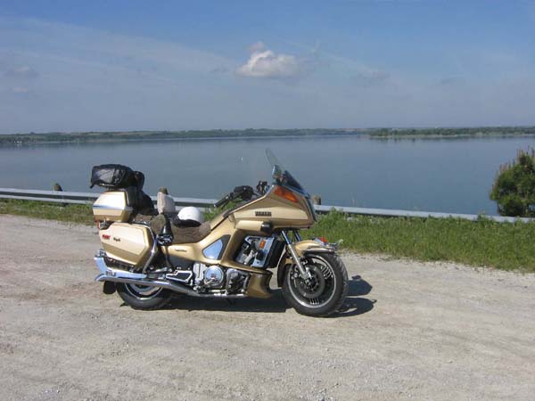

dingy Posted May 22, 2010 Share #3 Posted May 22, 2010 The leg cowlings air flow is from the black intakes on the front fairing sides.. The airflow is forced through ducts inside the front fairing then directed down the leg fairings and out the vents. I have removed these fairings on my bike and I do notice an increase in the temps on my legs. This probably would be a bit uncomfortable in a higher temp climate than where I am in Ohio. I still have the airflow coming through the front intakes and out the bottom rear of the fairing, it just isn't directed over my legs as it once was. The attached picture will give you an idea of what the bike looks like with the lower leg fairings removed & side covers modified. I know members RandyA & Thom have had this mod for a while. It does give the bike a more distinctive look. Gary http://i1007.photobucket.com/albums/af193/gdingy101/PICT5697s.jpg Link to comment Share on other sites More sharing options...
