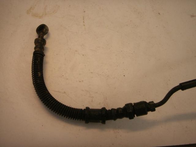

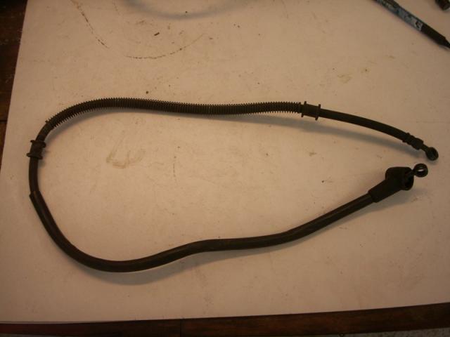

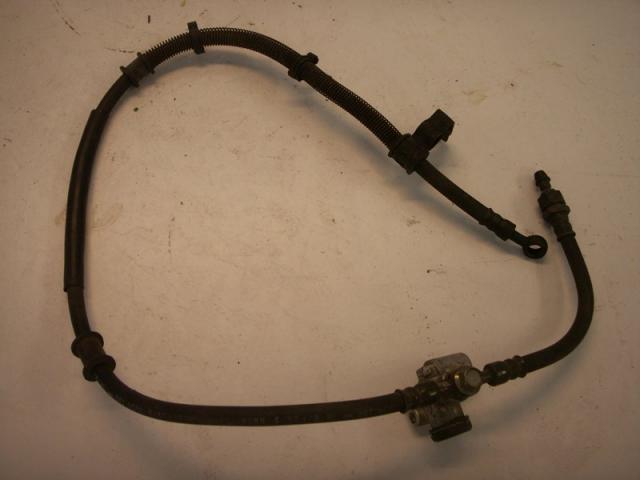

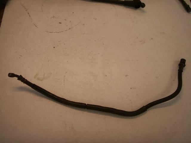

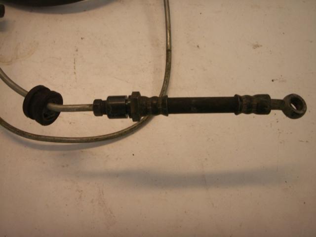

dingy Posted May 16, 2010 #5 Posted May 16, 2010 (edited) Here is a list of lines I have from my 1st gen 83. I would treat these numbers as reference only. I tried to get accurate measurements though. Rear Master to rear caliper. 18 3/8" from C/L to C/L of banjo fittings. One banjo fitting @ 15 deg. Both banjo fittings rotated @ 90 deg. to each other Rear Master to front steel line at rear master. 4 3/4" from face of 10mm fitting to C/L of banjo fitting. Banjo fitting @ 15 deg. Front metering valve to front caliper. (This line is from a 1988 bike with the upper bleeder port). 8 5/16" from face of 10mm fitting at top bleeder to C/L of double banjo fitting. This segment would be eliminated for 83-85 models without upper bleeder port if desired. 33 3/4" from C/L of double banjo fitting to C/L of banjo fitting at brake caliper. Banjo fitting at brake caliper @ 15 deg. Bottom banjo fitting is rotated @ 90 deg to double banjo fitting. Front master to brake caliper. 44 1/4" C/L to C/L of banjo fittings. Top banjo fitting @ 15 deg. Bottom banjo fitting @ 15 deg. Two banjo fittings are in line with a combined angle of 30 deg. Anti dive valve. (MKI only) 11 1/2" C/L to C/L of banjo fittings. Top clutch line 22 1/2" C/L of banjo fitting to face of 10 mm fitting. Banjo fitting @ 15 deg. Lower Clutch line 8 1/2" C/L of banjo fitting to face of 10 mm fitting. Edited May 30, 2016 by Freebird Added rear brake line
