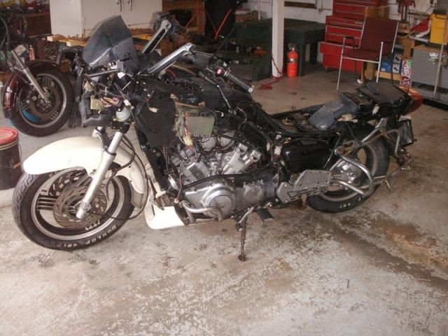

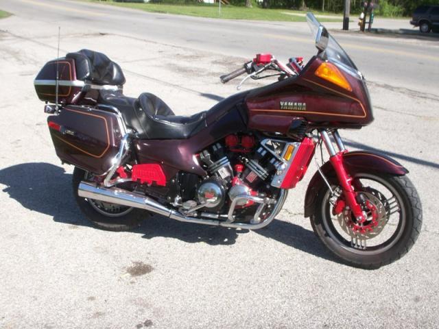

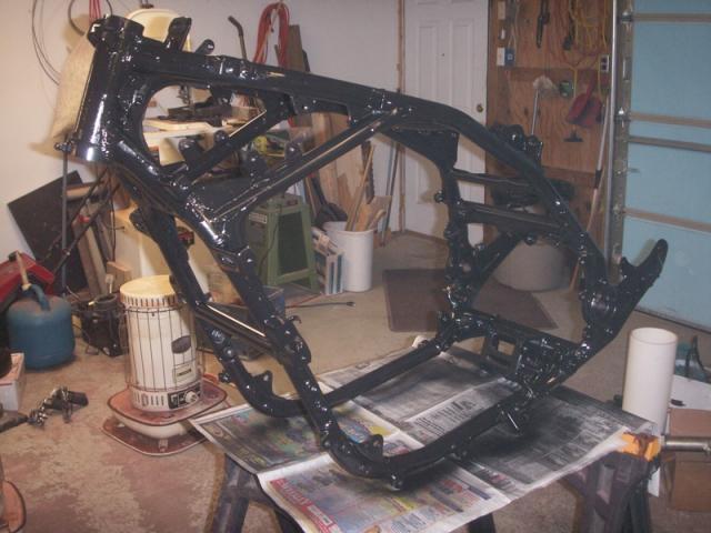

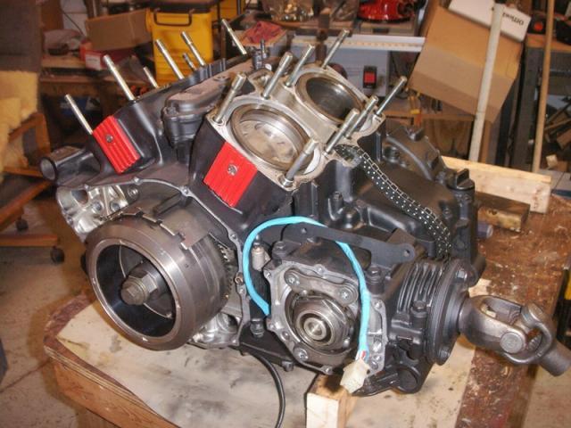

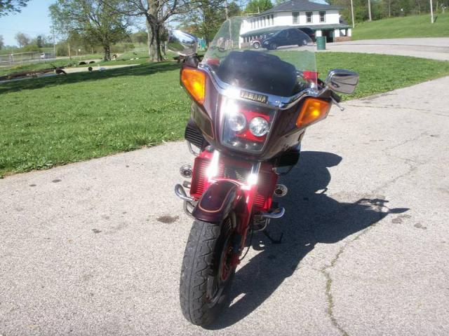

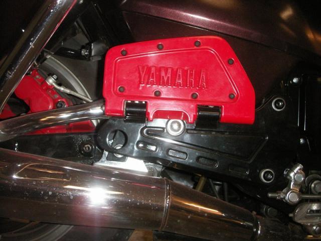

dingy Posted May 5, 2010 #1 Posted May 5, 2010 (edited) My re born 83 had its coming out party today. It is finally all back together. There are parts from 3 different decades on this bike. It will be a different color next spring. Probably a bright blue or yellow. Thanks to everyone that contributed knowledge and parts to get this done. Below is a list of the major improvements this winter and a few pictures of it. 1300 engine, 1988, 28,000 miles Vmax Heads, 1997, 19,000 miles FJR rear end, 2004, 7,000 miles MKII front forks, 1986 MKII brake calipers & rotors - front & rear MKII brake master cylinders - rebuilt Delinked brakes Stainless steel brake lines Speed bleeders Kevlar brake pads Electric Anti Dives – only operate on front brake Rebuilt clutch master & slave cylinders Stainless steel clutch line set Two diaphragm springs in clutch Replaced half clutch plate with full plate Starter ground upgrade 8mm ignition wires Iridium spark plugs K&N air filter Crankcase air breather filter Re-jetted mains to 140 Shimmed needle jets to .072” Updated rear shock to one with spring Grease fittings added to shock linkage Halogen Dual Projector Headlights Added tail light bulbs to rear turn signals Cruise control Class system Royale instrument cluster 1988 wiring harness Changed radio to AM/FM CD player 3 way speakers in front -Tweeters in saddle bags Shorty antenna Relocated TCI to radio compartment Radar detector & GPS mounts Bikini side covers Polished case covers S.S. bolt set for side covers Passenger foot boards Moved backrest rearward 2” Powder coating Pictures today. Started out as this. Went down to this. Donor of lower engine and brakes. Edited December 2, 2017 by Freebird Added engine close up

dingy Posted May 5, 2010 Author #6 Posted May 5, 2010 How does it run? Do you like the de-linked brakes better? I de-linked mine and have not rode it yet . . . It has a LOT more acceleration. I can pop the front end up fairly easy now. Red line is now close to 9000 RPM's. Seems like I need to upshift when I am in 5th though due to FJR rear end, it will take a little getting used to the higher cruising RPM's. As far as the brakes, I am happy at this point. The rear will not lock up on me which is good in my opinion. The fronts will lock up, which could not be good, but will be same as bikes I have always rode. I also made a revision inside of the wiring harness to keep the electric anti dives from engaging when only the rear brake is used. I have heard the electric A/D's are energy hogs. Didn't figure I needed them when I was only using rear braking. This way, if I am in traffic, I can use the rear brake and not have the drain on the electrical system. Gary
Monty Posted May 5, 2010 #7 Posted May 5, 2010 I like it alot...except for the bright red stuff, I don't care much for that. All the rest is kewl tho.

SilvrT Posted May 5, 2010 #17 Posted May 5, 2010 I like it alot...except for the bright red stuff, I don't care much for that. All the rest is kewl tho. DITTO on this ... it really clashes whith the color of the bike... but maybe you have plans to repaint a different color? Not sure what will go with those RED accented parts tho. That's a LOT of work you did... :thumbsup2:

ddoggma Posted May 12, 2010 #21 Posted May 12, 2010 Very nice. You do good work. The red does clash.... How about purple?
