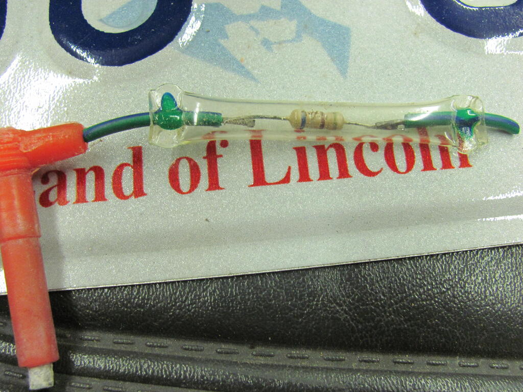

dna9656 Posted June 14, 2015 Posted June 14, 2015 Not as old as you! I went through this when I bought my conventional battery. On my first 83 the new battery came with the resistor right in the box so i was somewhat put out when buying battery for the newer 83.5 (17 years later) there was no sensor and to buy one from the battery maker was $50.00, the battery was only $30.00 ! So I made my own "sensor". Wow, this is an old thread. Some have connected that wire direct and never had an issue BUT there are also a lot of people the have fried a CMI by connecting that wire direct to 12V. The CMI is expecting to see about 6 volts on that wire. A CMI will cost a lot more than that $0.25 resistor.

camos Posted June 14, 2015 Posted June 14, 2015 yes old thread I have been skimming through the archives and this caught my eye...what is the CMI?Good question. Probably meant the CMS which is an acronym for Computer Monitor System which is the display unit in the middle of the dash that shows you all the warnings, the fuel level and gear positions.
skydoc_17 Posted June 15, 2015 Posted June 15, 2015 This will also do the trick: http://www.venturerider.org/forum/photopost/showproduct.php?product=58&title=first-gen-1983-1993-battery-icon-bypass-lead&cat=17 Earl
Flyinfool Posted June 15, 2015 Posted June 15, 2015 Good question. Probably meant the CMS which is an acronym for Computer Monitor System which is the display unit in the middle of the dash that shows you all the warnings, the fuel level and gear positions. Yup. Meant CMS, brain fart..... Went back and fixed post.
