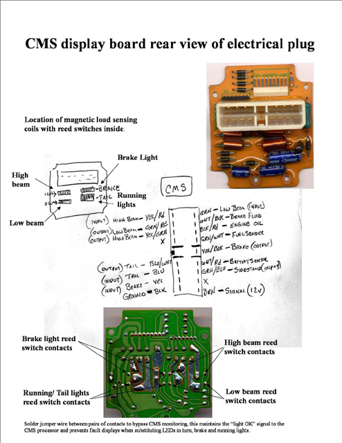

JoeKanuck Posted August 13, 2010 #53 Posted August 13, 2010 (edited) I just did an hid mod on my 86. It was a bear of a job getting the cmu out. The 86 unit does look different than the one pictured but it still has 4 of the things which need shorting. Jumpered all 4 while I was in there. The rsu is slightly different as well. I jumpered the plug as pictured and everything worked except that the headlight lamp went on with the highbeam and not the highbeam indicator. It seems I don't have a blue/green wire...just green. No problem. I just swapped bulbs in the dash. It works great and nobody would ever guess. It is a job worth doing but it is not a straight swap. Maybe someone can work out a way to avoid the warnings without rewiring but for now it will take a bit of mechanicking. Totally worth it tho. The light is so bright that road signs are like car hi beams on brite. Edited August 14, 2010 by JoeKanuck

Flyinfool Posted June 23, 2011 Author #55 Posted June 23, 2011 I have been getting a lot of requests for where to find out about jumping the reed switches in the cmu, here are 3 threads to get you started. http://www.venturerider.org/forum/sh...3&postcount=10 http://www.venturerider.org/forum/sh...5&postcount=11 http://www.venturerider.org/forum/sh...ad.php?t=33285 These are for an earlier MkI cmu but the principle is the same and the parts that need to be jumpered still look the same.

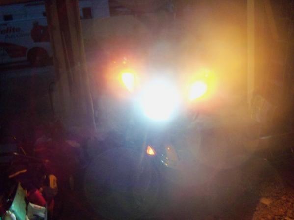

Dmnordin Posted November 25, 2011 #57 Posted November 25, 2011 I added an HID to my '83 Frankenbike w/'86 engine & Vboost, and I modded the wiring harness/jumper, and I add manual switches this past year when I rebuilt my bike. I also added 2, 5+" headlights with HID on custom mounts that I made that go where the horn used to be. I absolutely love it! I call the extra headlights my "landing lights" - one friend said my bike looks like an apache helicopter when I ride behind him. I have an on/off switch for the main headlight HID, and an on/off/low only switch for the landing lights which I usually just have them on & lo/hi with the main headlight. Doug
reddevilmedic Posted November 25, 2011 #58 Posted November 25, 2011 i have just the single low beam in mine at 6000k. superbright! its been in about 6 months with no issues at all. not even at starting. also, here is the cmu layout for a jumper wire to get the headlight warning icon off the dash.

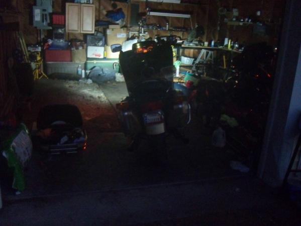

camos Posted September 2, 2012 #63 Posted September 2, 2012 Before I talk about my HID install I want to voice my appreciation and thanks to FlyinFool for this post with all the details and pix because it inspired me to venture ahead. Thought I would be doing the install today but it is a much bigger job than expected. I have the all the parts necessary to install HID in two headlights with a Hi/Lo H4 LED in place of the OEM headlight. The LED will likely only be useful as a DRL and I hope it is adequate but won't know until it is installed. The main harness needs to have a normal H4 connector spliced in to accept the LED. The relay and connector harness is meant for a car and so the proportions are wrong to fit a bike so will require rearranging. Also the connectors at the headlight end won't fit through the wire hole so the headlightwill need some attention as well. The good thing about doing an HID conversion this way is that there should be no issues with starting as well as double the light output. Did a single HID conversion on my Virago two weeks ago which works great. No RLU or CMS issues there. Just need to hold down the start button before switching the ignition on. KISS.

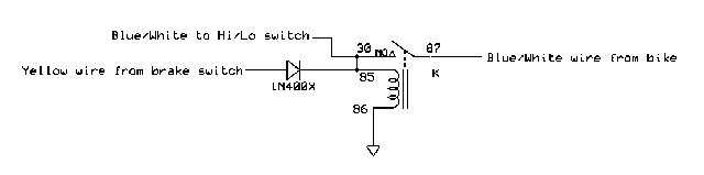

Flyinfool Posted July 3, 2014 Author #66 Posted July 3, 2014 (edited) Just another update. 4 years and my HID is still going strong. I now have it switched on by using the brake lights as the trigger. Even with the seperate switch and blinking red light, I found I was still forgetting to turn on the headlight in the daytime. I know that I will not ride very far at all without using one of the brakes. Nothing to remember. Headlight comes on when you hit either brake for the first time. Headlight turns off with the key. If you hit the start button after the headlight is on, the headlight will turn off until you hit either brake again. This would come into play if you should kill the engine for some reason and have to restart. The hookup is so simple that it was hard to see at first. Prep a relay by connecting a wire from pin 85 to pin 30. I used a piece of solid wire and soldered it as close to the case as I could so that I can still push on the connectors. Connect pin 86 to ground. Find the yellow wire that runs from the front brake switch. Tap into this wire and connect it to the anode of a diode (1n400x or similar). Connect the cathode end of the diode (the end with the stripe on it) to pin 85. Find the blue/white wire that goes to the high low beam switch. Cut this wire. Connect the side that goes to the hi/lo switch to pin 30 and connect the bike side to pin 87. How it works. When you turn the key on the blue/white wire goes hot, that is the normal feed for the headlight. But since it is connected to the NO relay, nothing happens. When you hit the brake it closes the relay and the power is sent on to the headlight. The little jumper wire on the relay holds the relay closed until something causes a power interruption on the blue/white wire. The only 2 things that should cause a power interruption on the blue/white wire is turning off the ignition switch or pressing the start button. The Diode is there to keep the blue white wire from back feeding the brake light. I also looked into why the white light was coming on instead of the blue High beam indicator. It seems there is an error in the wiring diagram in the service manual, they had these two bulbs reversed. I have gone back and edited my original how to with the correct wire colors. Or you can just pull them out and switch their positions in the dash panel like you guys did. Edited May 20, 2018 by Freebird
RedRider Posted July 4, 2014 #67 Posted July 4, 2014 Jeff, That is a beautiful solution. Really like the brake trigger idea. One time I had my HID go out at night. Fortunately, I was in the middle of Iowa at the time and there wasn't a curve in sight. Had forgotten to turn on my running lights also. Pitch black. Major pucker. However, I grabbed the brakes. That would have triggered it back on. As it was, I cycled the ignition and it came back on. Perhaps next winter. I am done working on the bike for this year. Time to ride. RR
