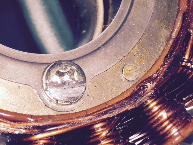

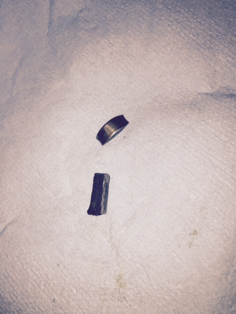

FiDude Posted August 1, 2015 Posted August 1, 2015 Prairiehammer, Thanks for the reply Yes, I did use the crankshaft bolt to turn the engine (which I'm guessing was the wrong thing to based on your msg) yes, it was torqued to 94lb/ft yes, it does have the stator cooling kit installed I did take the starter clutch out last night I think I found a couple of problems 1. the keyway was "split" into two pieces 2. the stator bolt head is half ground off 3. found a small scuff mark on the crankshaft right next to where the keyway is supposed to go - but not gouged or scored Hope I didn't do any damage to the crankshaft - based on pics do you think I damaged something Also can I buy just the keyway somewhere ?
Prairiehammer Posted August 1, 2015 Posted August 1, 2015 [ATTACH=CONFIG]100912[/ATTACH][ATTACH=CONFIG]100913[/ATTACH][ATTACH=CONFIG]100914[/ATTACH] Prairiehammer, Thanks for the reply Yes, I did use the crankshaft bolt to turn the engine (which I'm guessing was the wrong thing to based on your msg) yes, it was torqued to 94lb/ft yes, it does have the stator cooling kit installed I did take the starter clutch out last night I think I found a couple of problems 1. the keyway was "split" into two pieces 2. the stator bolt head is half ground off 3. found a small scuff mark on the crankshaft right next to where the keyway is supposed to go - but not gouged or scored Hope I didn't do any damage to the crankshaft - based on pics do you think I damaged something Also can I buy just the keyway somewhere ? It appears that the rotor/flywheel became loose, allowing it to slide toward the stator. One or more of the starter clutch bolt ends caught the stator mounting screw head(s). When the interference happened, the woodruff key may have been sheared then. If you tried to torque the crankshaft bolt after that happened, the specified torque may have been indicated but the sheared woodruff key may have prevented the rotor from seating fully on the taper of the crankshaft. The rotor has to be keyed in the proper position; if it is off, the timing will be off. I'm guessing the rotor came off relatively easily? Usually the rotor is a bear to get loose. In addition to the damage to the stator mounting screws, the stator windings are also scraped and damaged. You will need three new stator mounting screws and a new stator. The Woodruff key should be available at your local Yamaha dealer. That same key (PN. 90280-05029-00) has been used on hundreds of Yamahas, right up to some 2015 models. I don't believe the crankshaft key slot is damaged enough to render the crankshaft ruined. [h=1][/h]
FiDude Posted August 1, 2015 Posted August 1, 2015 Yes, the rotor came off very easily almost no tightening of the puller was needed. I've called all the local yamaha dealers in the area and nobody has it in stock and they all have to order it I wonder if local hardware stores would carry the woodruff key The stator windings didn't look damaged but in the pic it looks like it - I think that is just the shavings off the mounting screws - I will check it again in person
Flyinfool Posted August 1, 2015 Posted August 1, 2015 After talking on the phone it was determined that the key was not in the slot on the flywheel when he torqued the bolt. This left the flywheel sticking out to far and caused the damage to the stator and its screws. When he went to start the bike the flywheel spun on the shaft until the key fell into the slot, that is what caused to bolt to be loose and falling out on its own. With the flywheel loose there was enough free play to let the flywheel rock back and forth to shear the key. It looks like he might be lucky with the stator, It looks like some insulation was scraped off the windings but that the conductors may not be damaged. He will look closer to verify. If it is just the insulation scraped off it can be repaired with a few coats of varnish and a smear of epoxy. Either way those stator screws will be a bear to get out.

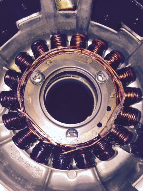

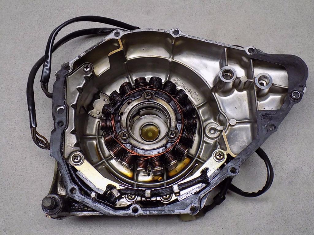

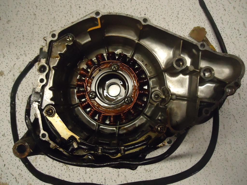

FiDude Posted August 1, 2015 Posted August 1, 2015 Took a look at the stator - doesn't look "damaged" or broken wires - looks like there are "scrapes" on the wiring (pic attached - can post more if needed of anything specific) Hopefully I can "fix" them as FlyinFool suggested Can't even get any kind of "grip" on the screw heads to try to take them out No local Yamaha dealer has the keyway in stock - they all have to order it I'm going to go try the local ace hardware (as one of the dealers suggested) and see if they have something Any suggestions would be welcome

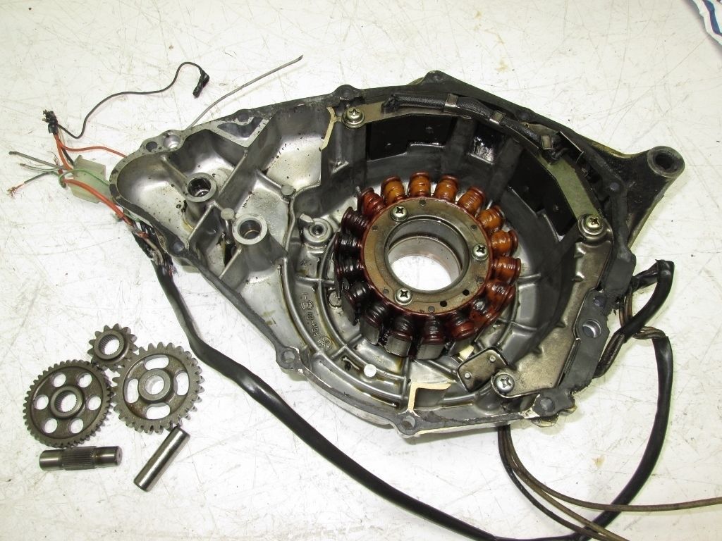

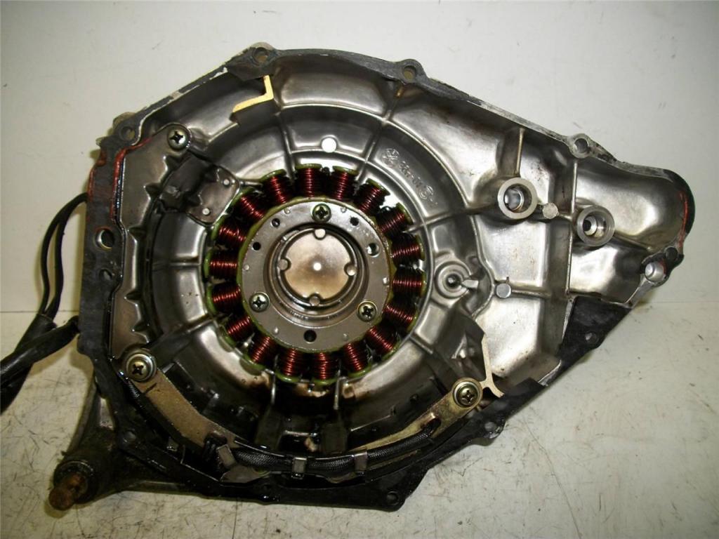

FiDude Posted August 1, 2015 Posted August 1, 2015 Am I better off getting a "used" crankshaft cover with the stator in it than trying to pry the current stator screws off and "fixing" the current stator Here are some that I found on ebay - any suggestions on which one "looks" good Unless someone in the group here has one available Thanks in advance for all the help.
Flyinfool Posted August 1, 2015 Posted August 1, 2015 It is hard to tell in the pic, but that wire fro 10:00 to 11:00 in that pic sure looks like it is scraped. It is not just if a wire is cut, if there is any damage the reduces the cross section of the wire, then there is a good chance it will burn out soon.
Jayceesfolly Posted August 2, 2015 Posted August 2, 2015 I would use a little heat, from a propane torch, on the three screw heads of the stator, as they are secured with Loctite. Then use small vise grips to get the screws started out. Can't help you with the scraped wires, I'm electrically challenged and wouldn't know a good wire from a bad one. Jim
syscrusher Posted August 2, 2015 Posted August 2, 2015 The heat is a good idea. If you're scrapping that stator then put toothpaste all around the circumference of that screw. It's cheap heat protection paste and it will also prevent the filler material from bonding to the stator plate. Then braze in the part of the screw that is missing with some gear building brass filler rod. When that has cooled carefully use your Dremel tool with a cutoff disc to turn the phillips head screw into a flat head screw (cut a slot across it). Finally, use a manual impact driver to remove the screw. A manual impact driver is the kind you hit with a hammer. Make sure the impact driver is set to turn counter-clockwise when struck. Or buy a new cover with the stator installed. How does your existing cover look? Mine is UGLY! Maybe I'd cover your shipping costs to send me the one you won't use..........
Dano Posted August 2, 2015 Author Posted August 2, 2015 Pic #2 is the only one that the stator doesn't "look burnt". The darker images on the windings are indicative of too much "high amperage" or "shorting out" going on.....I agree with Flyinfool and that's why I had you talk to him about this.... Good luck in the repairs. Dano
camos Posted August 3, 2015 Posted August 3, 2015 I would use a little heat, from a propane torch, on the three screw heads of the stator, as they are secured with Loctite. Then use small vise grips to get the screws started out. Can't help you with the scraped wires, I'm electrically challenged and wouldn't know a good wire from a bad one. Jim If the visegrips can't grab the screw head well enough to get it out then grind the heads off, remove the stator and see if vicegrips will remove the remaining shaft. If not, apply some more heat to the shaft and perhaps some penetrating oil before trying again. When removing stuck screws you must be firm but gentle and persuasive. Snapping one off is migraine territory.

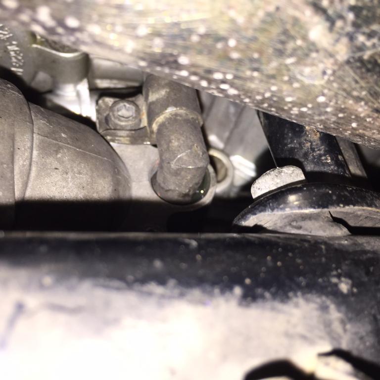

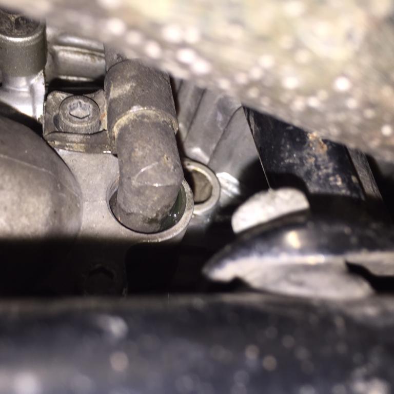

FiDude Posted October 15, 2015 Posted October 15, 2015 (edited) Hello All Sorry for taking so long to get back on - Dad's medical problems and hospital visits took up quite a bit of time. He is recovering and doing better. Thanks for all the suggestions that were given to fix my problems. I wound up buying a new side cover with the stator (one suggested by DanO from the pics I had posted earlier) The end of the wires did not have the standard connectors - took a while to figure out which wire goes where - hopefully I have it right. I had a heck of a time trying to find a replacement keyway (to replace the one that broke) - took over a month and a half (every dealer I called said it was on back order) to find one in MA and it took them almost 2 more weeks to mail it out - have no idea why. Anyway finally put everything back together (definitely a major learning experience for me) and started it yesterday (after almost 2 years). (WAS MUSIC TO MY EARS - yeaaaahhhh) The cranking/starting problems I was having are finally gone - hope it stays that way. Having a couple of problems after all that 1. A tiny oil leak from the bottom of the new side cover near the shift lever - don't know if the side cover itself has an issue (like a crack) or something is not sealed right - everything is tight - double checked. 2. Since I used to have a constant overheating problem before - I thought why not fix that too since I had most of the front of the bike apart anyway to change the starter clutch and rebuild the starter I changed the O-rings and the thermostat (which seemed to be stuck in the closed position - hopefully causing the overheating) - Now I'm having a water leak from where the bypass tube goes into the thermostat housing base (pics attached) - (Don't know why the pics turned sideways) I have reseated it multiple times trying to see if the leak will stop - but no luck. Even tried to use an o-ring that was listed for a 2000 VMAX 1200 ( was a very tight fit trying to get it in there) - but didn't seem to help either. I checked with the local dealer and they verified that there is NO o-ring or gasket that is supposed to be in that location. Looking for suggestions on what can be done to hopefully stop the leak. Someone suggested using "RTV" (I'm guessing that is some sort of silicone sealer) - to stop the leak - don't know if that is the correct solution. Would appreciate any suggestions/solutions for the problem. Edited October 15, 2015 by FiDude
Flyinfool Posted October 15, 2015 Posted October 15, 2015 1. The oil leak might be from near the top where the stator wires exit the cover. That is a very common leak point. If it is leaking at the bottom, you probably missed a little cleaning up of the old gasket or gouged one of the gasket surfaces while cleaning. 2. When you had that out did you clean the hole? There is often a lot of corrosion in there that makes it hard to seal. If the surfaces are pitted an o-ring alone will not seal against a pitted surface. You will either have to smooth it out or cheat with some sealant. It also looks like you have the tube tilted and not aligned with the bore.
