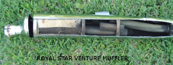

footsie Posted October 27, 2009 Posted October 27, 2009 (edited) If you look in the outlet end of your stock muffler, you will see a tube that runs the lenght of the muffler, these are a reverse flow type muffler, meaning the exhaust gases flow from the input to the back and then back to the frount and back again to be expelled. This is how the exhaust is muffled, there is no plate in the muffler full of holes to muffle the sound, the back and forth flow does it. So if you cut the tube approx 1 1/4 to 1 1/2 inches up the outlet end, and prize it over to one side, the muffler becomes straight through flow, with some backpressure formed by the part of the tube that is remains attached to the rear cone. I have done this to my 2000 and my 2004, it gives a good sound under hard accelleration, and has enough back pressure to prevent the popping. Running down the highway it quiets down, I don't even notice the sound at highway speed. But sounds great running at 55 and around town, but not loud enough to be noticed by Law enforcement. If you look at the mufflers you can't tell that they have been modified, in daytona I have seen Law enforcement stick a billy stick up the end of the muffler to see if the baffle is there, it won't go in. I will try to draw a diagram and post it. You need a dremel tool with a cut off wheel to do this mod, it takes several wheels because they break easily. To me it sound better than the road king mufflers. I am willing to help. Gregg Gregg Edited October 27, 2009 by footsie

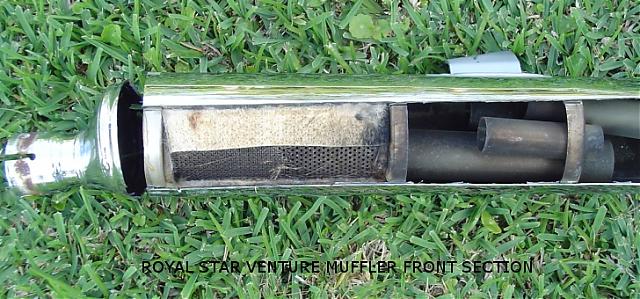

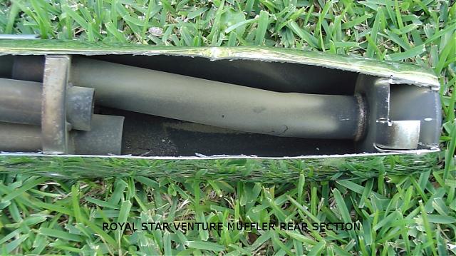

KeithR Posted October 27, 2009 Posted October 27, 2009 (edited) Here are some muffler cut away pic's I borrowed from somewhere. Keith Edited July 22, 2019 by Freebird
footsie Posted October 28, 2009 Posted October 28, 2009 You can see in the pics the reverse flow design, the exhaust gases flow to the back, pass back forward through the short tube then flow back out toward the outlet. If you cut the outlet tube into, and push it aside, you can look straight through the muffler. Well not perfectly straight, but you can see through it. The deeper you make the cut the more back pressure you keep, quieter. I have mine cut about 1 1/4 inch from the outlet. Gregg
DavidD Posted November 12, 2009 Posted November 12, 2009 As many time as I read about cutting the mufflers with a dremmal tool and moving a pipe I just don't get what is being done. Can someone post pics so this dumb guy can understand this?
footsie Posted November 23, 2009 Posted November 23, 2009 David Look at the third picture in the post above, toward the right side is the out end of the muffler, you see the tube going into the cone at the very end of the muffler, that is what you are to cut into with the dremel about 1 inch past the cone up in the muffler, once cut it will easily prize over to one side and open up the muffler. Gregg
